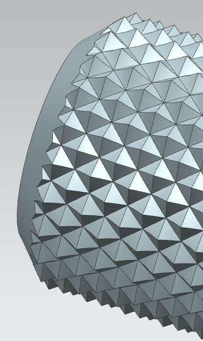

      Adisa,

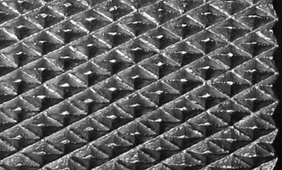

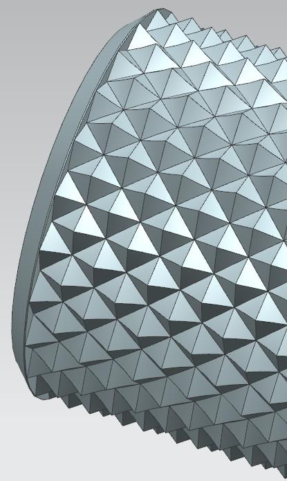

      I looked at your knurled metal pin that you want to insert into a plastic hole.
      It has a "cap" surface that is not easily manufactured, and that cap will affect how the plastic will flow as the pin is inserted into the hole.
      If I make a 45 degree chamfer on the end of the pin, I can remove the cap. This will be make it easier to insert the pin in the hole.
      Do you really want that cap, or do you want a chamfer on the knurl?
      Also, you will get two different patterns of deformation in the plastic hole depending on whether you push the pin straight in, or if you screw it in. What do you intend to simulate?

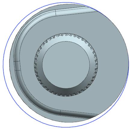

      Adisa,
      The plastic part is not concentric about the pin.  Has a circular "plug" been cut out of a much larger part to provide some geometry for this analysis?  If so, is the diameter of the cut, and its location somewhat arbitrary?  Or is the plastic part an actual complete part?

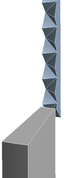

      To make a much smaller and simpler model, assume that the plastic part is symmetrical for an initial model.  Then take a small slice of the pin and plastic and use symmetry planes to model that small slice. In the image below, I slice at the peaks, you could slice at the troughs if you prefer. I also cut a big hole in the steel pin since it is much stiffer than the plastic. You could have a zero radial displacement BC that replaces the metal in the center if it deforms too much.
      Below is what that slice looks like.
      But if you look at a close up of knurled metal parts, they don't have sharp tips. I recommend you add a blend to the tip of each pyramid.
      What material properties do you have for the plastic?
      This problem is going to be extremely difficult to simulate.
      Peter
      Here is one tooth ready to gouge into the plastic.

      I wanted to see how close the hole is to an edge of the part.
      If the hole is less than one diameter from an edge of the part, then that edge and the adjacent hole wall can deform outward in a way that the hole wall 90 degrees around cannot. That would make it so you can't use symmetry and the problem would be extremely difficult to simulate. I'm going to assume that this is not the case since you would need a massive cluster of computer cores solving for a week to do the entire pin in a hole near the edge.
      If the hole is more than three diameters away from an edge, then the pin entering the hole will behave the same as if the hole were in an infinitely large part. In that case, you can use symmetry to slice one row (or two rows) of teeth because any row (or two rows) is the same as any other row.
      So let's consider the symmetric case. Viewed from the hole, there are 44 identical teeth around the circumference of the pin, but every other row has a half pitch lag. Viewed from the side of the pin, a row has a first tooth, then the rest of the teeth in that row. The first tooth will act like a tool and gouge a groove into the plastic. The second, third and all the rest of the teeth will follow in this groove. The groove may spring back slightly after the first tooth passes, so the second tooth will have to push it back out slightly, but not the way the first tooth had to. That is why I recommended a one tooth model.  On second thought, a two tooth model would be better.

      The hole is about one diameter from an edge of the part.

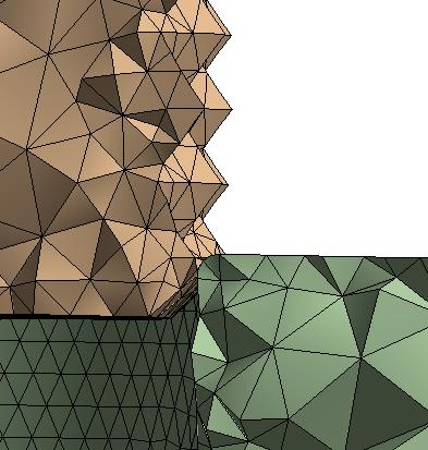

      Adisa,

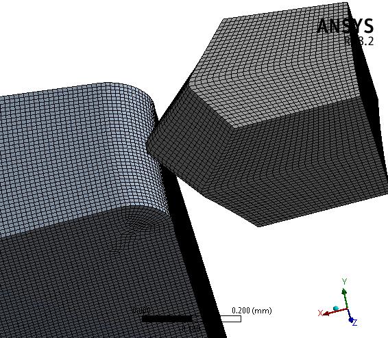

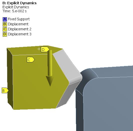

      I attached my one tooth model that ran for nearly 8 hours on a 12 core computer.
      Here is how far it got:
      It will need to run for another 48 hours (or more) to make a groove 0.5 mm long. Since I didn't have your material file when I started this analysis, I used an Explicit material: POLYCARB that uses an Equation of State instead of Multilinear Plasticity. I artificially increased the material density by a factor of 100 in order to reduce the solution time, which was in the hundreds of hours without that density change. I could use a factor of 1000 on the material density to reduce solution time even further, but at some point, the artificially increased inertia forces will affect the results and they will no longer accurately represent the real problem.
      This model might take less time to run in Static Structural than it is taking in Explicit Dynamics.
      Your mesh is too coarse to do these kinds of simulations.
      My single (or two) tooth model might be useful to predict the insertion force for the pin. I can take the reaction force for pushing one (or two) tooth and multiply it by 44 to get the whole pin.
      You are interested in trying to predict cracking. Something frequently done in engineering analysis is to create a simpler model and predict if that will crack, and if the prediction is that it will not, that means the more complicated model will definitely not crack, since the simpler model was made using conservative assumptions. For example, if you made a smooth solid pin at the same diameter as the tips of the tooth, that would have to stretch the plastic more than it would get stretched by the teeth, which cut grooves to make space the way a smooth pin would not. This is called a conservative model. If it passes, your real geometry is going to pass.  Of course, this is only a useful model if the conservative model passes, if it fails, you can't say that the real model will fail since it may not.
      Peter
