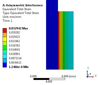

      Hello Adisa,
      You have a pin that is larger than the hole. There are two simulations that are of interest. The simplest one is the state of stress when the pin is fully inserted in the hole.  The complex simulation is the isertion of the tapered pin into the hole.  Let's do the simplest one first.
      You have axisymmetric geometry and loading, which means you can do a 2D model, which will take less time to solve and will compute the stress in the plastic (and steel). I see you have a mulilinear plasticity model for the plastic.
      The geometry is drawn of the two parts assembled and there is an interference present. The contact elements will resolve that interference. You don't need to move any parts, just support the bottom of the pin with a Y=0 displacement constraint. The axis of the pin will be on the Y axis.
      The material datasheet shows the strain at break to be 4.5%. This means that in your simulation, when the Total Strain is > 4.5% the part cracked.
      You can use 1/2 symmetry and cut the pin and sleeve to half their length.  This is what the sketch will look like: two rectangular surfaces that overlap by the radial interference. The dimension H5 is half the internal diameter of the plastic. The dimension H2 is half the diameter of the pin.  Dimension V7 is half the length of the tube. When you create the second rectangle, Add Frozen. And before you start, change the Geometry property to 2D.  I didn't use your geometry, I made up my own, but the solver finished in seconds and made a result with your material. This my geometry, the prediction is that the plastic will not crack since total strain is 0.033 < 0.045.

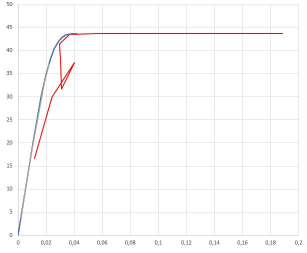

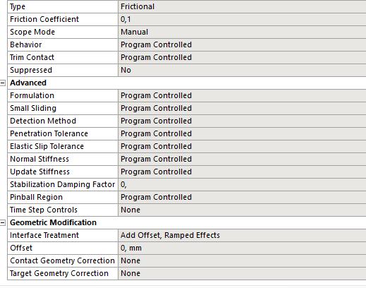

      The red curve is results of stress and blue is input stress for multilinear isotropic hardening. The contact properties.
      The below pic is for triangle elements.
      I do with one shell another solid body. I have some errors  (DEVIATIONS from real stress) and i need to increase interations and refinement mesh, and if I have total strain bigger than 4,5 % the construction will cracked. OK.
      Now I need to do second simulation, the complex simulation is the insertion of the tapered pin into the hole. I can also do the second analysis as the first, I need to determine stress on plastic part.

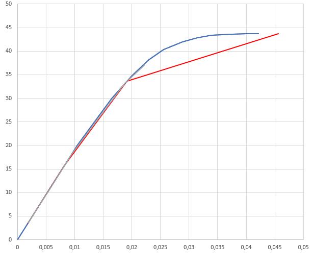

      I did slice of the second analysis, and I get this results.
      Blue is input stress-strain, red is result.
      The slice analysis is attached, one is solid another part is shell.
      These analysis are examples for axle press, axle has teeth, where I need to apply to complex structure, where I can not use shell because construction is complex, and because it  I need this example do with solid.
      In the complex with axle-teeth, The results of stress-strain look like this:
      Tetr elements are used, solver is converged but the results have more error, devitation of real stress strain curve, what Ineed to do that cut down errors. the strain of 4,5 is exceed but the stress at 4,5% straiina is not 45MPa.

      The red line on your chart seems to be a long way from the blue line, but the line is not data. Only the points at the end of each red line are data. Don't draw lines between the data points.
      To make more points on the Charts, change the Analysis Setting of Minimum Substeps to 10.
      Why plot a chart?  Why not plot what I did, which shows the distribution of strain through the thickness?

      I plot stress strain curve, because I thought that real curve must be equal with results and that criteria must be and stress and strain.
      I used stress and strain for crack, for example, the part will crack when is t.strain  bigger than 4,5 % and stress in that point must be 40 MPa, and that I used as verification analysis when is curve equal of results as input.
      Can I use only total strain for criteria, for exmple that total strain is bigger than 4,5 % but stress do not equal 40MPa,  the result of stress is different of 40MPa. i.e Total strain is criteria for creck reckless on value of stress.
       Adisa,
      You should use Total Strain to compare with 4.5% to evaluate if the part would have cracked, regardless of stress.

      Adisa,
      ANSYS requires you to put the Target on the Rigid part. It won't let you put it the opposite way.
      Regards
    • Sandeep Medikonda
      Hi Adisa,
      Indeed Peter is correct. In fact, not just ANSYS but all commercial FEA codes that I am familiar with recommend the stiffer/rigid body to be specified as the Target/Master body.
