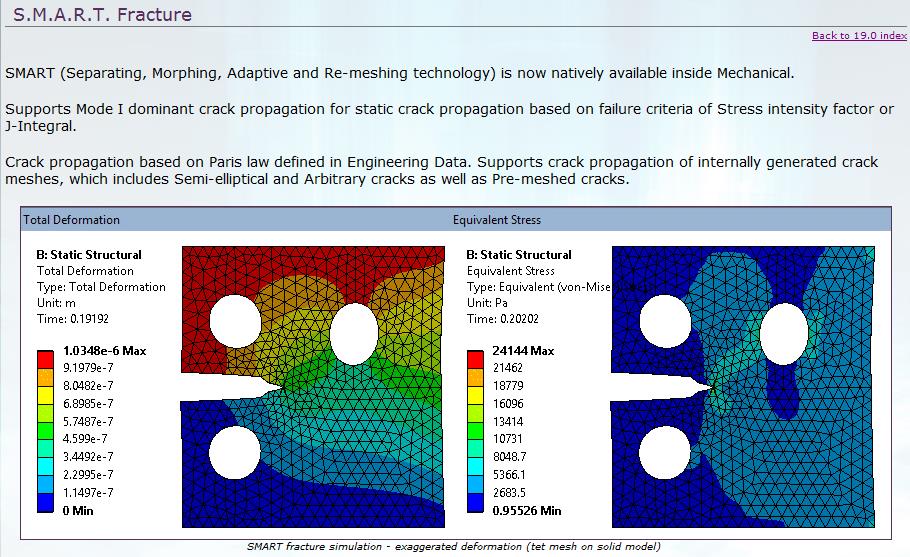

      I don't see your archive. Here is the ANSYS 19 new feature...

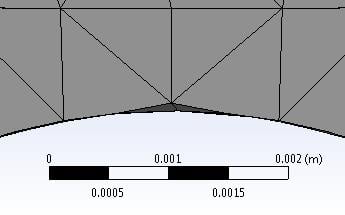

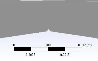

      I have been using a the smart crack feature but the geometry simply deforms without crack growing. Any ideas why that would happen. I have tried to reattach the files and a picture of the results am getting. Thanks once again
      I had a first look at your model. There may be more than one reason why your crack does not grow. The first reason I found was that your mesher has defeatured away your crack.
      Change Mesh Defeaturing from Yes to No.
      While you are there, change your Element Order to linear.
