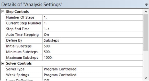

      Hi, I would like to know how can I obtained the crack patterns of concrete in ANSYS Workbench for many sub-steps.
      Knowing that I am using the following code, but it gives me only the cracks in the end of solution. I have only one step and 1500 sub-steps and I would like to see the cracks at15%, 30%, 50% and 75% of the maximum load

      You can do this by changing the substep of the set command. For example if you want al 50%:
      set,1,750
    • Amin
      Did You mean that I can do it by changing "last" to sub-step number that I need in set command?
    • Yato
      Yes, try to do that.
    • Amin
      It worked Well, Thank you for your help

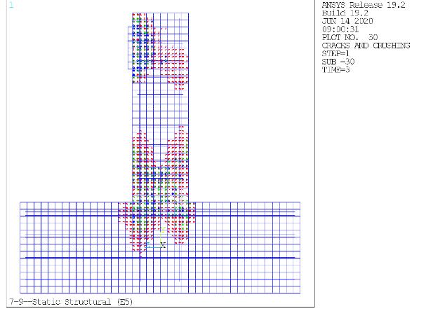

      Crack Pattern
    • Amin
      Hi Ricky,
      Unfortunately, I didn't find solution to present the cracks as you mentioned. In my model, I tried to divid the applied force to many steps than include sub-steps for each step to overcome convergence issues. when I didn't get the cracks as you menstioned, I reduce the steps to one step and incrsease the sub-steps, as in the attached image. Using this way, I could see the cracks at each level. If you find a way to show the cracks, please share it with us.
      Best regards
      Amin.

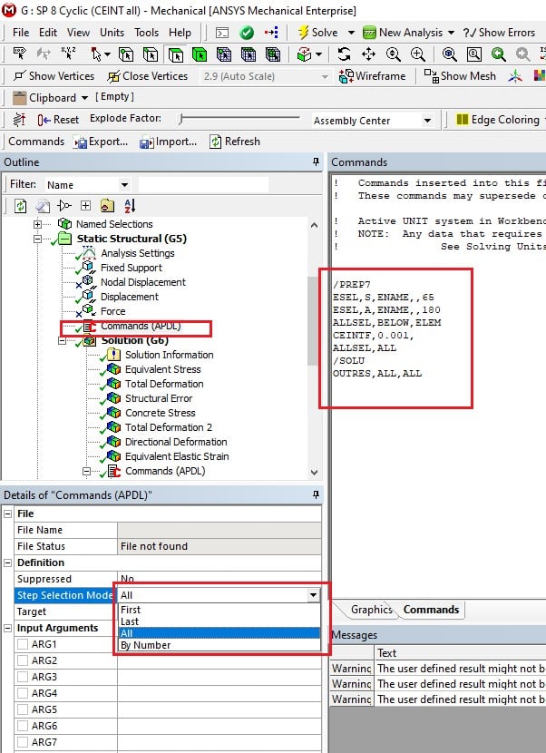

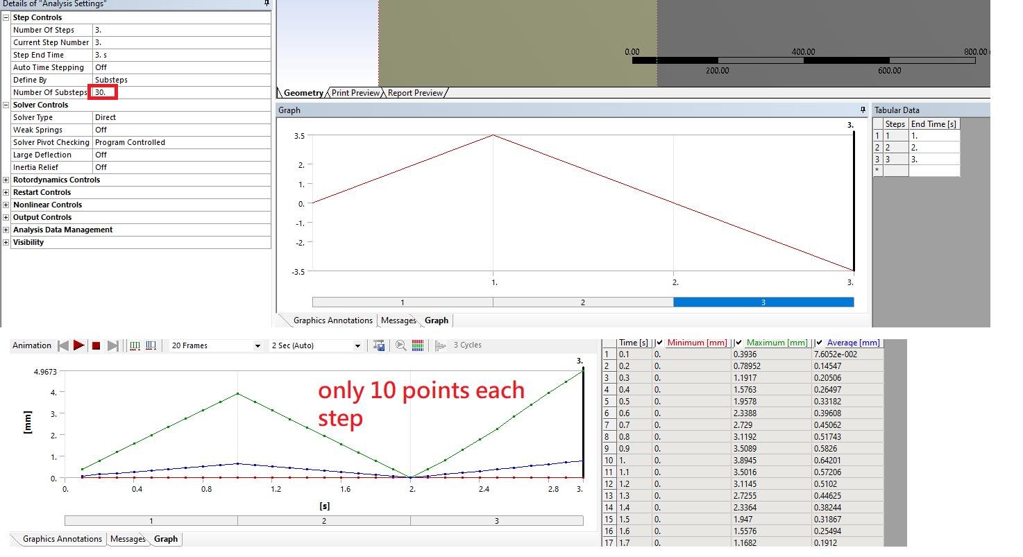

      Actually I found a way to present the cracks for the cyclic loading up to the last substep of the last load step. The result will be similar to this
      Using this method
      you change the step selection mode from "First" to "All"
      However, something weird occurs if I use this setting. ANSYS seems to reduce my substep (from 30 to 10points).
      This is a problem because I will face a convergence problem before I finish my simulation.
      Also, in the crack picture, you can see that it sets to step 1, although it already reached step 3
      Ricky

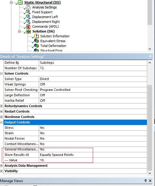

      I finally found the method to display all the cracks on every load step. you set the general miscellaneous from no to yes, and store results at "equally spaced points", fill the value as you preferred. I recommend you to choose "equally spaced points" or else your data will be very big because it will save all data from your substeps. The tradeoff is that it will affect your stress, strain graph etc, so adjust the value as you desired.
      Below is the PLcrack command that I use to display only the last substep of every step of the crack. Copy the last part as many as your load step
