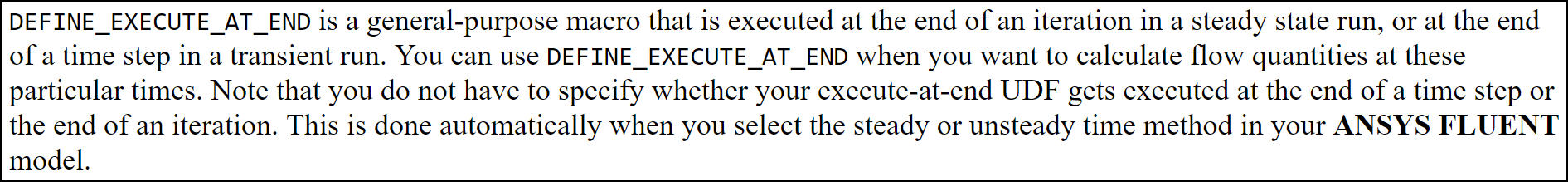

I am curious about if it is possible to update reference values per iteration using UDFs in a transient simulations. Would DEFINE_EXCUTE_AT_END potentially work?Â

If you want to change any values which are calculated by fluent, it can be done through DEFINE_ADJUST function. DEFINE_EXECUTE_AT_END will do the function at each and every iteration.Â
DEFINE_ADJUST will adjust the defined variable with the value in UDF. Hope this will help.
