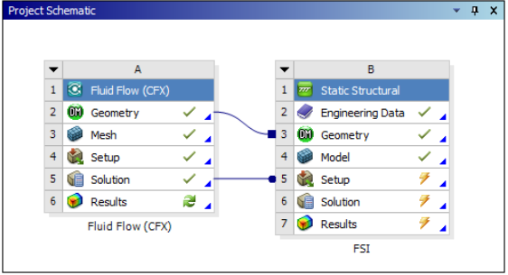

      Hello Everyone,
      I just started using CFX, so I'm a little confused about it. How can I couple the CFX results with the transient thermal analysis and what inputs do I consider?
    • Rahul
      Hi Nithin,
      Are you interested in 1-way data trasfer or 2-way data transfer?
      Please refer Oscillating Plate FSI Co-Simulation with Partial Setup Export from Workbench (CFX-Mechanical) (ansys.com) a tutorial for 2 way FSI with CFX-Mechanical Coupling.
      You can also couple CFX results with the Mechanical as shown in image.
      Please refer Using Imported Loads for One-Way FSI (ansys.com) for more information.
      Hope this helps you!!
