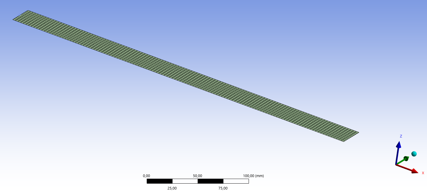

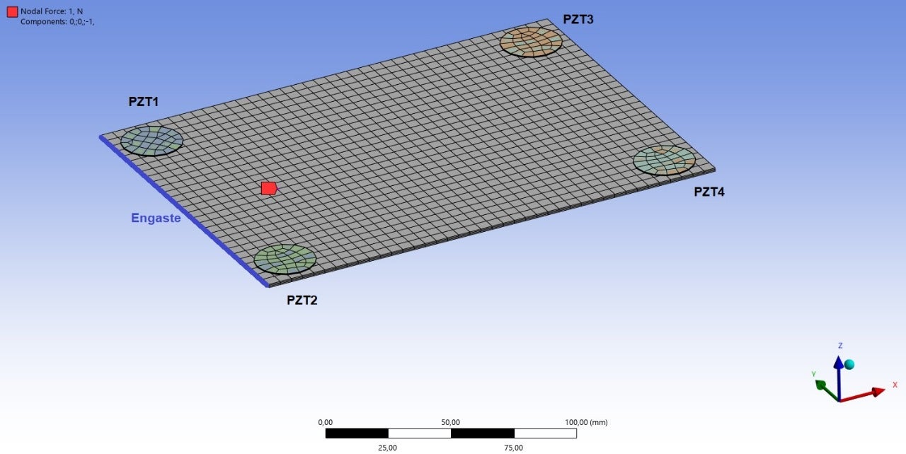

    • brunozanelli
      I am trying now in a simple geometry. I made a beam surface and it does not work. I keep getting this warning. I set the shell elements to be only structural analysis and still it doesn't work.
    • Erik Kostson
      Hi
      Well it is coupled physics so we can not just have one part with single physics only (that would be like doing a pure static or harmonic analysis, and the coupled system is not for that of course)  – so you must also have the pzt in the same model.
      Erik
