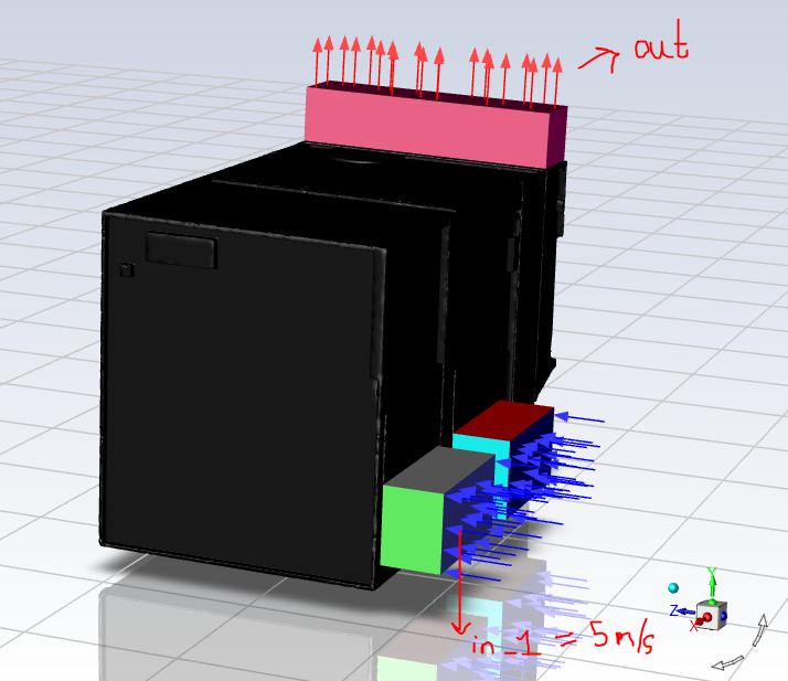

SubscriberI'm simulating an airflow into the enclosure through the inlets as shown. based on the hand calculations for a velocity of 5m/s, the mass flow rate should be around 0.375 kg/s . But I'm getting unrealistic values at the inlet as well the exit when I'm using monitors for flow rates. i have attached some screen shots of the geometry as well as the monitor plot.

Forum ModeratorStaff are not permitted to open attachments so please repost. Check the domain extents too: you may have inadvertently scaled the domain.
November 23, 2021 at 12:15 pmavinashnair
SubscriberThanks for the reply Rob, the problem was solved. It was a case of units mismatch during CAD import.
