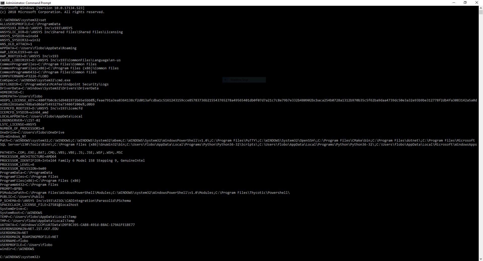

Ansys Employeeopen CMD Prompt, then issue the following command
set
and post the entire output of it here.

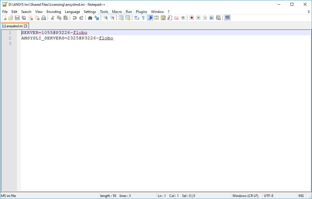

Also, go to your installation directory (e.g., C:Program FilesANSYS IncShared FilesLicensing) , then open ansyslmd.ini with any text editor app like notepad and post its content here.

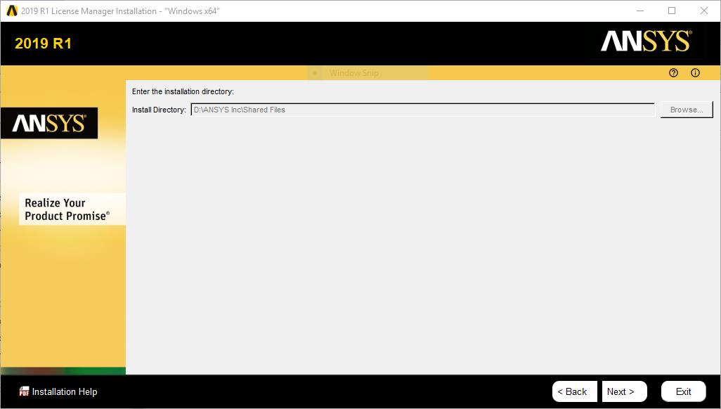

In order to change the default directory:Â ALL PREVIOUS INSTALLATIONS OF LIC. MANAGERÂ MUST BE REMOVED

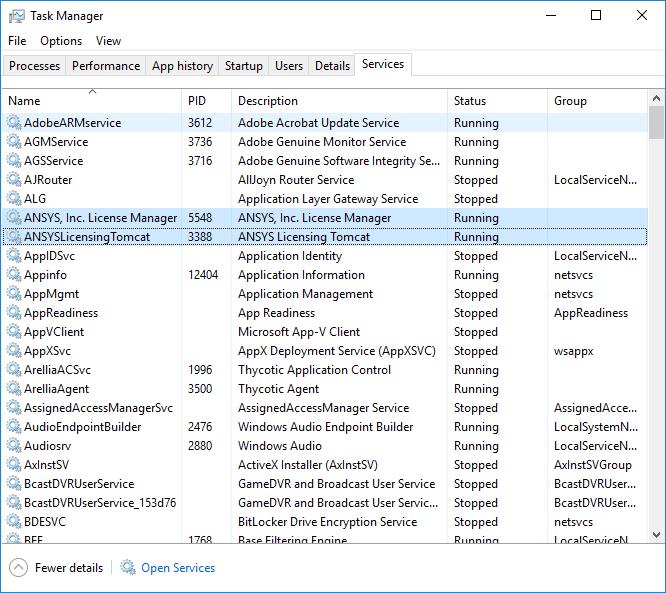

In some instances, that includes removing or deleting the license manager services:
If this cannot be performed using task manager, it can be done using the command prompt:
SC DELETE servicename
In the case of the services shown above
SC DELETE "ANSYS, Inc. License Manager"
SC DELETE "ANSYSLicensingTomcat"
Note that the " " may or may not be needed...
After, reboot/restart your machine!

Yes, this is correct, you should remove this and ANSYSLIC_DIR , so that you could change the installation path.
