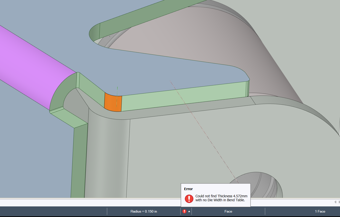

SubscriberI Just updated to 2020 R1. I am having trouble with adjusting the fillets on sheet metal parts. I have to suspend the sheet metal to do fill commands,  Or I have to pull the fillet to 0. The error that pops up says that there is no die width in bend table. There is obviously a work around, but it just changes how I am use to drawing.Â

SubscriberSubashni Did some more experimenting, this issues comes up with all fill commands in sheet metal mode. It also shows up with some of the sheet metal tools like edge and corner relief.Â

SubscriberGUICADÂ This worked, I guessed it would need the sample table in place, but keeping it blank fixed all the problems. Now to adjusted the default settings and should be back up and running full speed.Â
