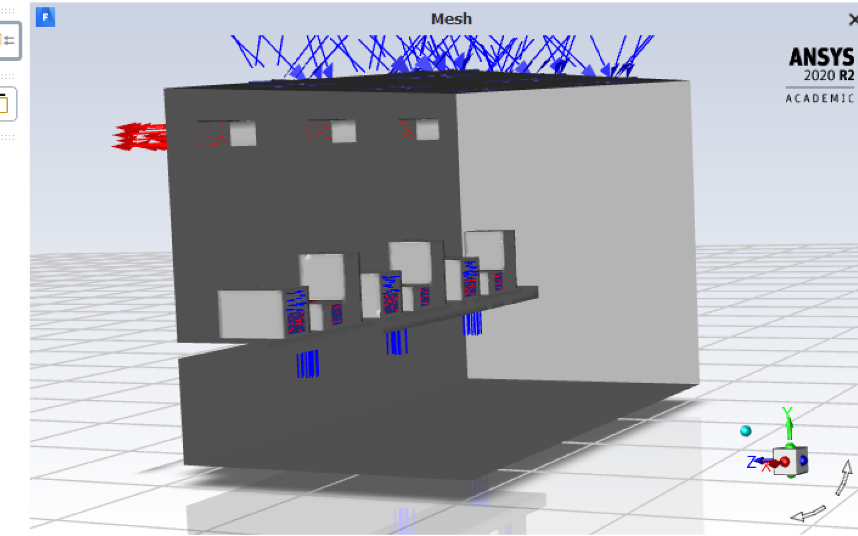

I am currently working on my master thesis. I am simulating a laboratory with three microscopes an three associated power supplies. Each microscope and power supply has a cooling unit. In the simulation the cooling units are defined as massflow outlet (entry in the cooling unit) and massflow inlet (exit of the cooling unit).
