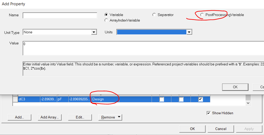

      Is there a way to convert an already assigned normal type variable (used for a nonmodel object) to a post-processing variable

    • AndyJP
      isn't it obvious?
      You can not use Post-Processing vars in your model. But such necessity may arise when modifying the project.
      GUI does not allow switching the var type.
      You have to delete it from all the formulas, reload the project, delete the variable, then create it again of different type, and again type in every of countless formulas you have in the project.
      Not very convenient.
      I was thinking about accessing the property with VBS script, or directly editing the project XML file.
      Not sure will it work, or not. Now I have different tasks to solve before trying that.
    • vinayshetty
      Hi, AndyJP.
      As you have mentioned, might be using VBS script or XML file would be helpful.
      I will give try and update here if these work.
