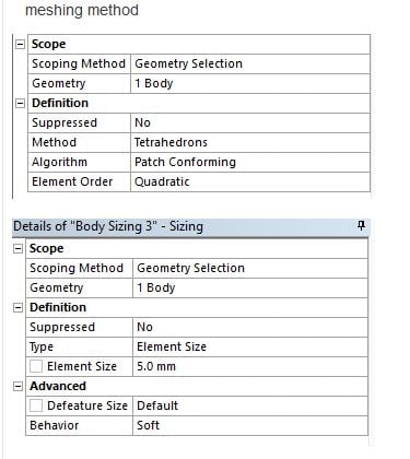

   Meshing of the SILICONE RUBBER - PART:
  Meshing of STEEL WALL: Set to default settings

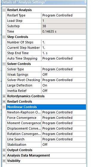

c. ANALYSIS SETTINGS

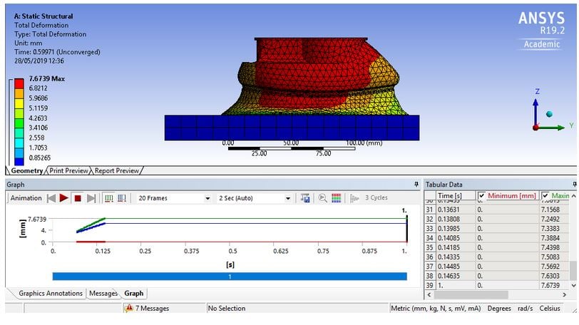

e. After letting it solve it, I face the ERROR . The solver engine was unable to converge on a solution for the nonlinear problem as constrained. Please see the Troubleshooting section of the Help System for more information.
So, instead of 50 mm of displacement it travels only for 7.67 mm.
