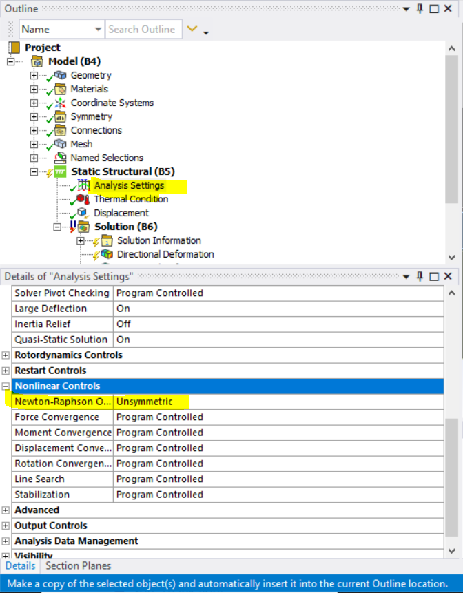

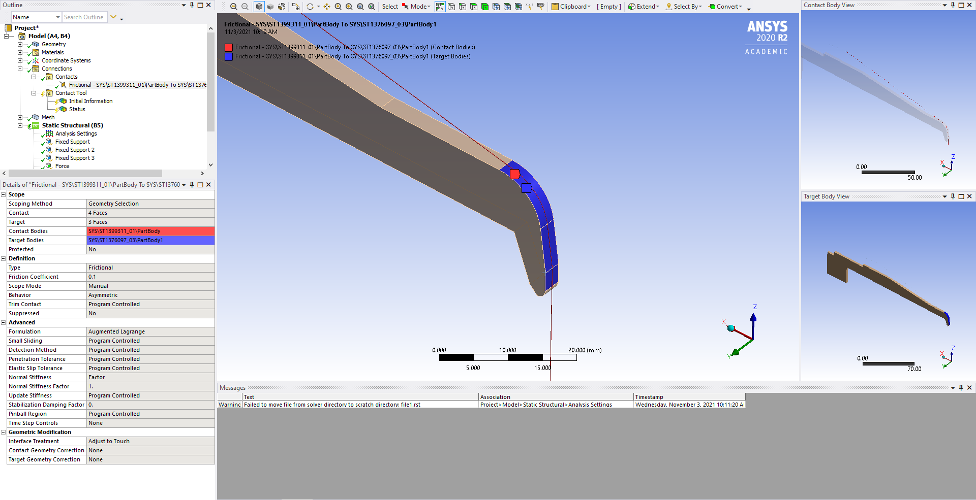

I am having difficulty in converging the following static structural analysis:
it is a frictional contact between a steel support structure and a tungsten wire. The wire, fixed at the ends (fixed support), is stretched by an upward force of 15N, while the support structure is also fixed with a fixed support.
The purpose of the analysis is to understand the effective contact area between the surfaces and the pressure applied by the wire on the support.
I attach some images where you can view the contact parameters and the analysis settings that I have assigned. I think these are the crucial for achieving convergence.

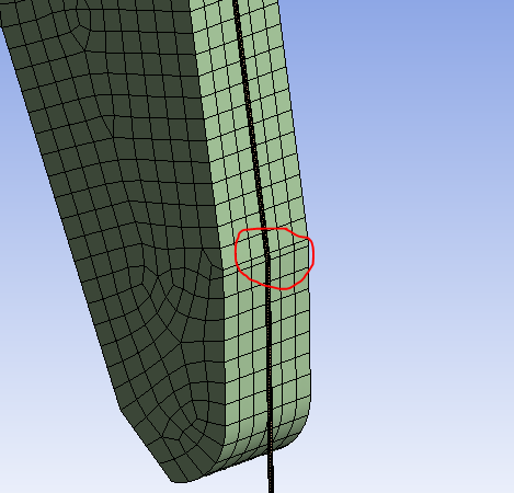

now I am launching analysis with a coarse mesh to have a not too heavy model and to be able to quickly manage the mathematical convergence;
Subsequently, the objective of the analysis is to calculate the effective contact area between the wire and the support, the contact pressure and the frictional stresses. For this I think that the mesh in the contact area is crucial, so I will have to improve it. Also, I think contact stiffness is another parameter to manage for physical convergence.

Also, starting with coarser mesh is good practice. But, you will have to use finer mesh in contact region between wire and support for proper contact.

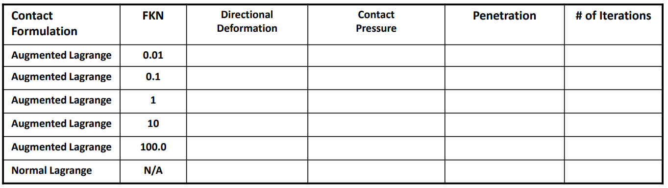

Normal stiffness value is actually a multiplier or a factor(FKN). If normal stiffness value is low, then penetration will be high but it will be easy for convergence. What you can try to do is change FKN as 0.1, 1 , 10 , 100 and record the results like contact pressure, penetration, directional deformation and decide which FKN is best for your application. (I have attached a table for your reference)
You can choose the best combination in terms of accuracy and number of iterations for your problem. Specifying the right contact stiffness is highly problem dependent. If localized contact-related results are unimportant, then the program controlled defaults might be acceptable.

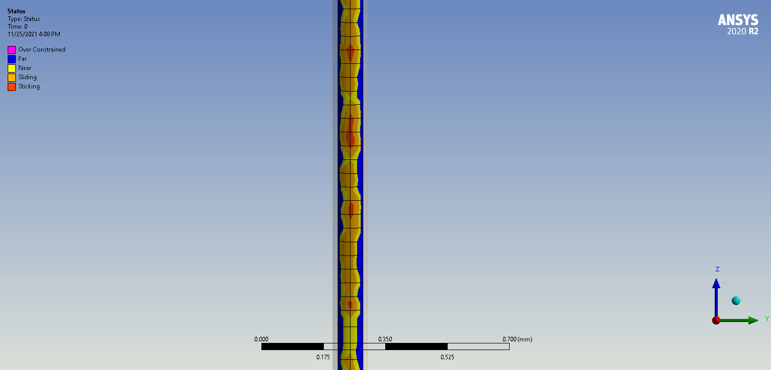

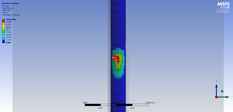

I am modeling a frictional contact between the two surfaces (wire and support) and what I should get as a result is a certain distribution of pressure on the contact surface. However, it happens that stresses are concentrated in a very localized area and the rest of the area is not in contact. By monitoring the elements in contact with the contact tracker, I realize that as soon as the sub-switches converge, I have a sharp decrease in the elements in contact.
Below you can see a plot of the contact pressure:
The pressure concentration zone is the one highlighted in red:
Furthermore, I am not very convinced of the initial state of the contacts:
Everything is very uneven and there are areas where the state is sticking.
Do you have any suggestions ?

Can you try fine meshing on wire and the surface of contact. You can add contact sizing or manually do fine meshing. Because of fine meshing, it will increase number of elements in contact. Due to which, pressure distribution will also be proper.
