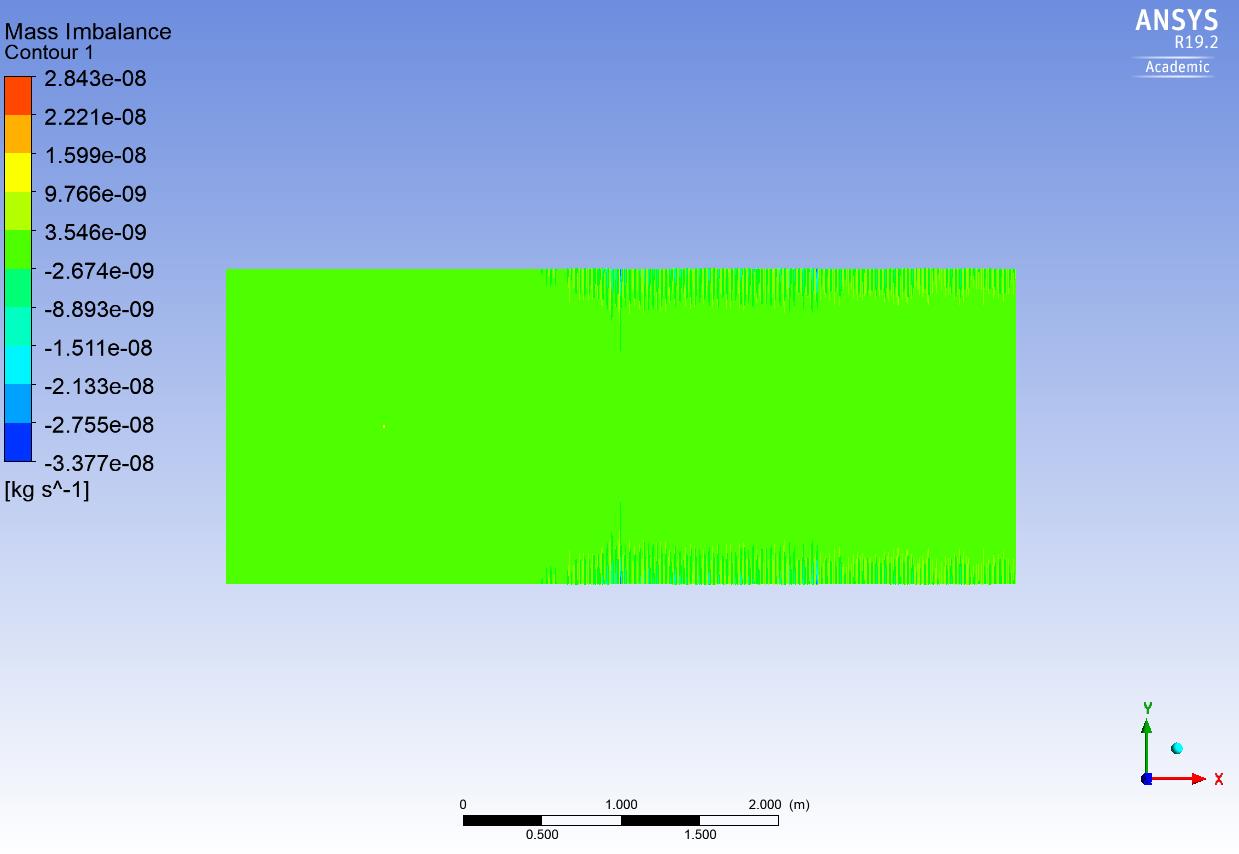

August 6, 2019 at 3:57 pm
Chris1opher
SubscriberThank you for your advice.
I plotted the mass imbalance contour and attached the pictures. As reference i attached a picture of the model with viscosity 0.0005 which is converging.
Can you tell if that could be the reason my system is not converging?
Is an imbalance of e-08 to high?
Viscosity: 0.0003 Pa s
Viscosity: 0.0003 Pa s Zoom
Viscosity: 0.0005 Pa s
August 6, 2019 at 4:10 pm
Amine Ben Hadj Ali
Ansys EmployeeLack of resolution for flow which might turned to turbulent using zero model for turbulence. This might be an issue and leads to high mass imbalances. What happens if you turn turbulence midel on for high Reynolds case. -
