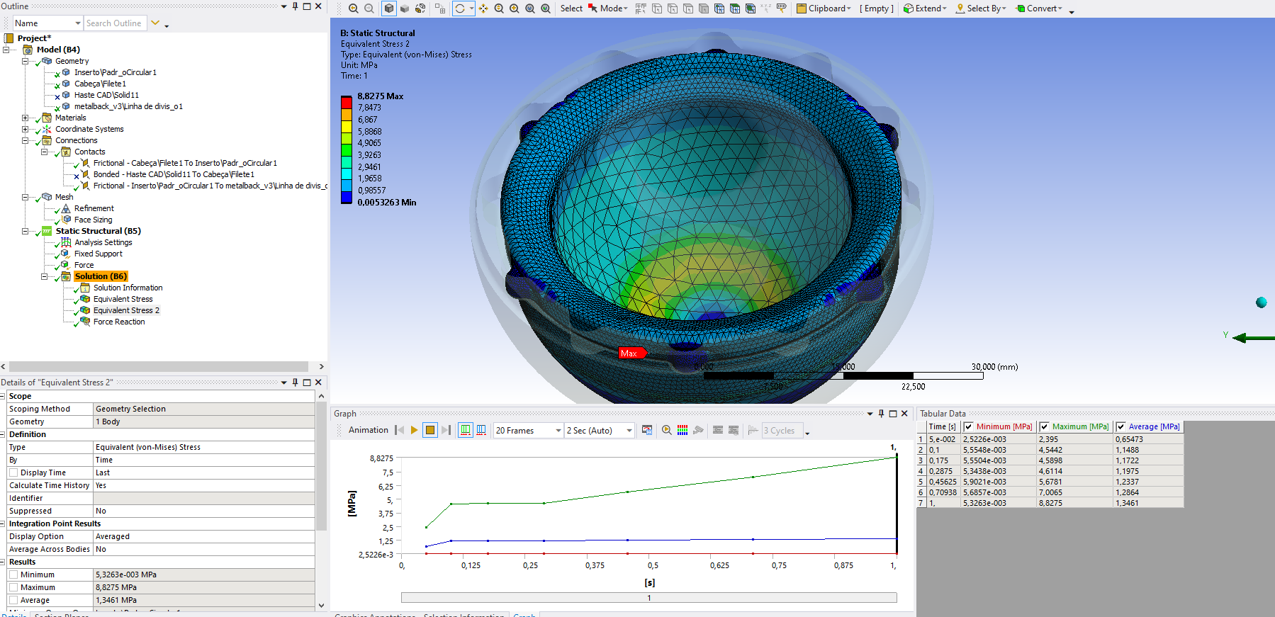

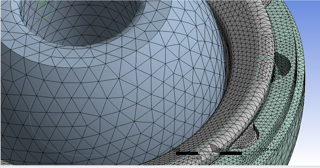

      Mesh (Figure 2)
         Default with adaptative size = 6
         Refinement around the small cup antirotative tabs

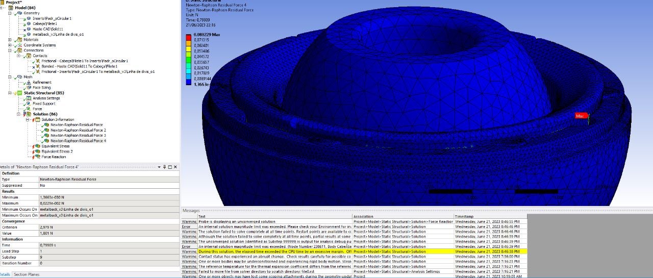

      2. The solution fails after a few iterations, there are three warnings:
      •    One or more bodies may be underconstrained and experiencing rigid body motion. Weak springs have been added to attain a solution.  Refer to Troubleshooting in the Help System for more details. (in the beginning of the simulation)
      •    Contact status has experienced an abrupt change.  Check results carefully for possible contact separation. (around 4th iteration with no convergence)
      •    One or more contact pairs exceeds contact small sliding assumption, check your results carefully.  Consider using Large Deflection or turning off Small Sliding on the offending contact pair(s).  You may select the first offending pair via RMB on this warning in the Messages window.  Additionally, you can use the “Number With Too Much Sliding” Contact Results Tracker to locate any additional pairs.

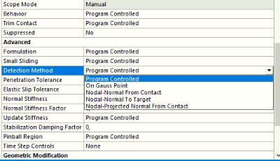

      3. I’ve selected the normal stifness factor as 0,1 for both contacts, but I couldn’t find the detection method as combined.

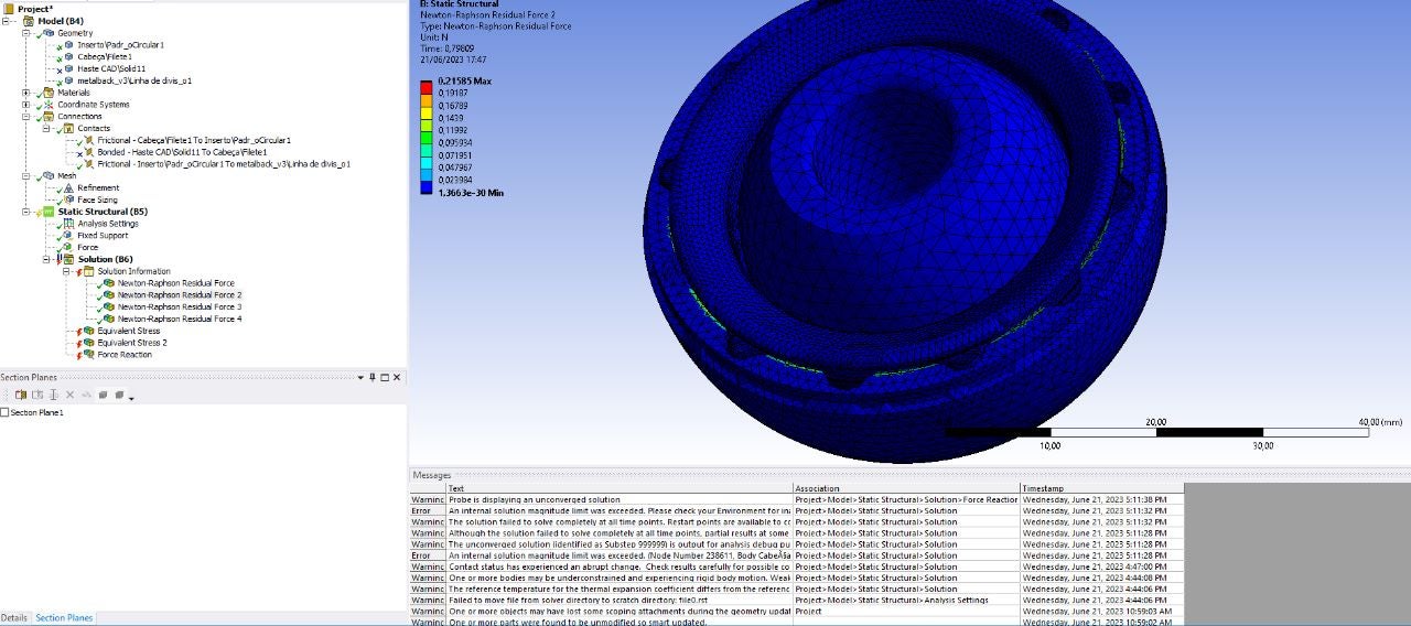

      A: Applying normal stifness factor as 0,1, the Newton-Raphson residual plot shows residual force in the contact inner surface of the outer bigger shell:
      B: Since the previous simulation showed residual force in the outer shell border, I’ve tried refining it. The residual force is low, but still present, still missing the convergence.
      C: Finally, it’s reached convergence, adding the normal stiffness factor 0,1 and Detection Method as on Gauss point.
