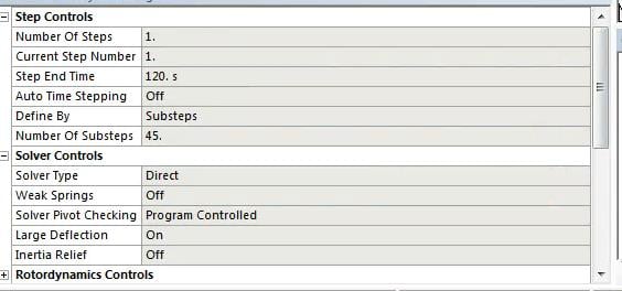

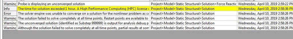

      I have a 3D DCB specimen and am modeling the delamination using the Bi-linear CZM Law. I am trying to match the load-displacement graph obtained from ANSYS with that from experiment. In trying to do so, I am trying to find the correct cohesive zone parameters. When I use a high value of the "normal displacement jump at the completion of debonding" (C2), which is anything greater than or equal to .1 mm, the solution converges, but the load-displacement curve is all wrong. However, when I lower the value to something like .095 mm or lower, the solution doesn't converge. I do, however, get partial results that looks much better. Here are the errors I receive:
      I have tried the following things to make my solution converge:
      -increased the sub-steps, here are my settings:

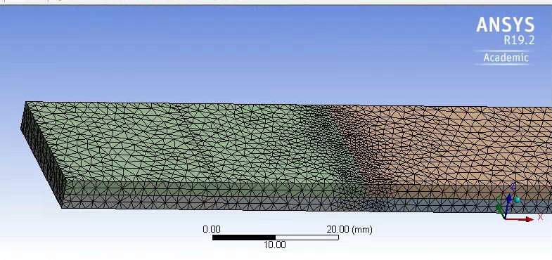

      -Refined the mesh at contact regions using contact sizing (I'm not really sure how much I should refine my mesh, it's possible I just haven't done it enough)
      - lowered the stiffness of the contacts
      - reduced the penetration tolerance
      -used the normal lagrange formulation
      What else can I do?
