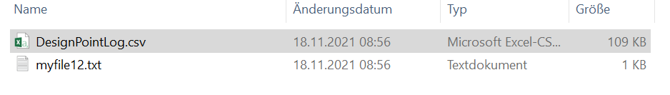

      Hi Sheldon thank you very much for your answer. I am using *CFOPEN to export Data. I tried your code in a command block in the solution branch with different DPs but I don't get different filenames in the directory.
      In the image above I have assigned the Parameter ARG1 to values from 12 to 14. In mechanical I set ARG1 as a parameter:
      However I only get one file in the subfolder called myfile12:
      I think I am on the right track and I am missing one simple Detail. Could you help me on this one?
      Regards BassaSelim

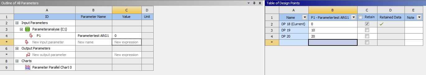

      Hi BassaSelim Go to the Workbench Parameters Page (in Workbench UI, not Mechanical UI). There, you can specify different values for "ARG1", which will be used in the filename. I'm guessing that all of your design points have ARG1=12, so that is why you don't see multiple files.
      Regards Sheldon
    • BassaSelim3

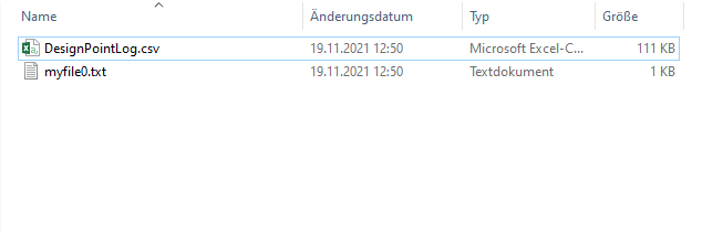

      Hi Sheldon In the workbench environment I set different values for different design points (0,10,20):
      However I only get one file:
      So only the current set is generated (in this case 0). Is there something I am missing out?
      Regards Bassa Selim

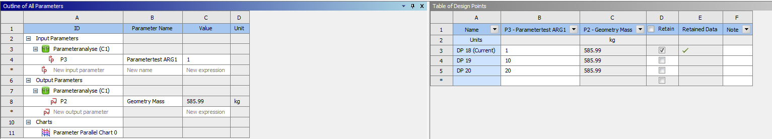

      Hi Bassa Selim You may need to add one output parameter (it could be something trivial, like "Mass" under the Geometry branch). Without it, then Workbench may not solve all 3 design points if there is no output parameter. Once that is added, ensure you use "Update All Design Points" since you have to run 3 cases, not just 1.
      Thanks Sheldon
    • BassaSelim3
      Hi Sheldon thanks for the support. I tried your solution:
      But I still get only one outputfile after clicking on "Update All Design Points":
      There must be one Detail I am missing
      Regards Bassa Selim
    • BassaSelim3
      I figured it out: I had to set the checkmark for the retained Data.
