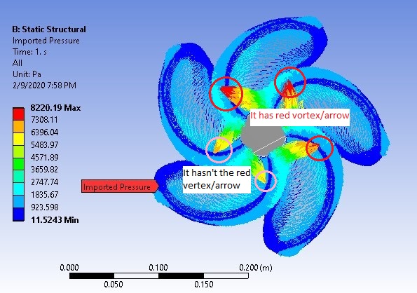

Subscriberi guys, now I'm currently working with CFX and Static Structural. I'm doing research on fatigue-life from Propeller KP-505. When I'm importing the pressure from CFX to Static Structural using the Imported Pressure feature, why the red vortex/arrow only appears on 3 blades (red circles), and the 2 other blades don't have the red vertex/arrow (pink circles)? Can somebody explain to me why this is happening?
I attach the screenshot below.

Forum ModeratorAnsys staff can not download images on the student portal, so if you want to reach a larger audience to get answers from, please insert the images inline. Also, did you check the import summary? is the exported result mesh and the mesh it is mapped on closely matchig?

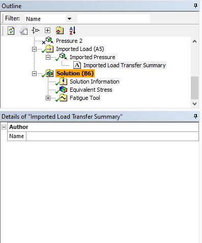

Aniket
Forum ModeratorWhat do you see in the Imported Load transfer summary? It should open in the worksheet showing the detailed summary. Have you crosschecked the results in CFX if those are matching with what is being mapped? Don't pay attention to colours check the values of pressures.
