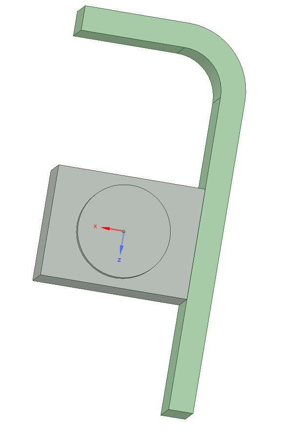

      I'm looking for a way to simulate cooling process of a circuit breaker. I'm troubled by contact resistance heat generation. I have two parts of electrical elements carrying current that are in contact. There is heat generation in each element, due to a current flow and I know how to eneable it in fluent. I don't know however how to enable some kind of 'surface generation' on the contact, to simulate heat generation by contact resistance.
      I would much apreciate your help.
    • Amine Ben Hadj Ali
      Can you add a sketch of your problem?
    • Rozpruwacz10000
      Sure, thanks for your reply.
      Current of 3000A flows trough this parts. Each of them has a resistance and there is also a contact resistance betwen them that disipates some energy. I was thinking about heat flux condicion on contact but this stiffens the model.
      You can assume a thickness to the wall separating the two bodies and here a resistance in normal direction will be modeled or you use shell on that wall or resolve that wall as a solid and assign proper solid material properties.
    • Rozpruwacz10000
      Thanks for taking interest in my submition Amine. I'll try using generation to thin wall on contact.
