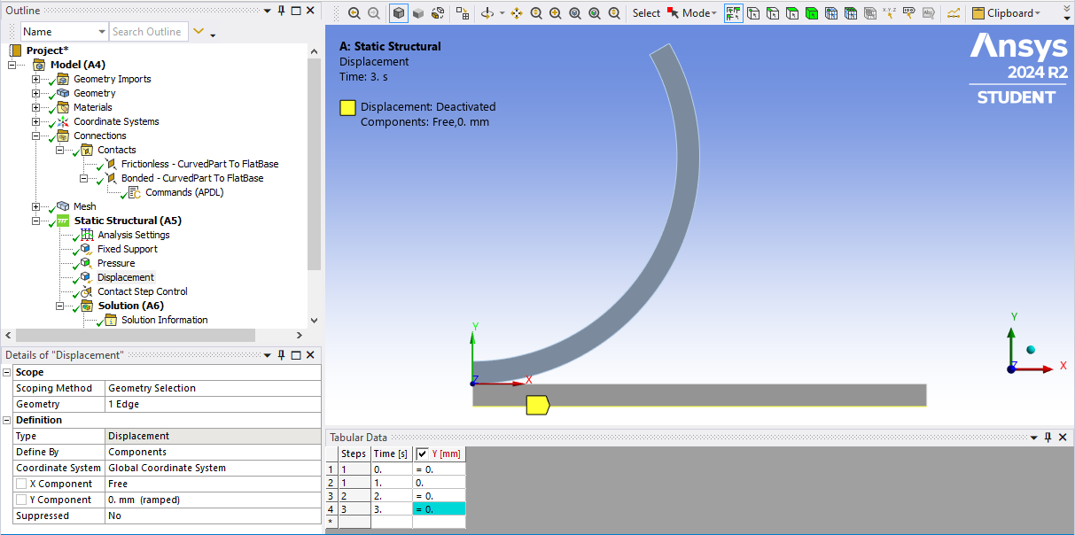

SubscriberI was interested to try this myself and built a 2D Plane Strain model to experiment with a CurvedPart and FlatPart. There is a Fixed Support at the left edge of the parts.
I have a 3 step analysis and two contacts defined, Frictionless and Bonded. Contact Step Control sets the Bonded Contact to be Dead in step 1.
The Frictionless contact has a large pinball radius of 30 mm which engulfs the entire two surfaces. The Bonded Contact has a small Pinball Radius of 1 mm and the Command Object under it is one line: KEYOPT,CID,12,3
The Pressure load ramps on in Step 1, is maintained in Step 2 and ramps to zero in Step 3.
The Displacement BC applied Y=0 to represent the surface supporting the FlatBase while the pressure is applied but that BC is Deactivated in Step 3.
The Analysis Settings have Large Deflection On and Auto Time Stepping On with Initial 100, Minimum 10 and Maximum 1000 Substeps. Here is the deformation at the end of Step 1 and 2. I didn’t make the pressure large enough to push the last bit down.
Here is the deformation at the end of Step 3 when the displacement and pressure is deactiviated.
Here are the tensile stresses in the bonded assembly.
Here are the compressive stresses in the bonded assembly.
