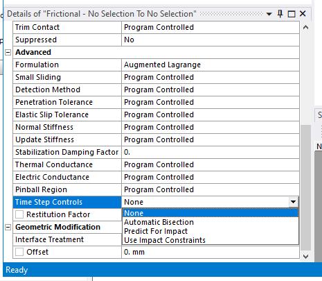

      Another factor is the time step controls. You can set the contact to Predict for Impact. Although Im pretty sure the system coupling overwrites this setting so it may be useless/unavailable for this case. The next image shows the offset Peter mentioned at the bottom of the details window.
      The general timestep size will always be the one set in system coupling. But, I can set for example 5 substeps per timestep, it will work the way that mechanical will have more than 1 substep per timestep, just the data is transferred at the last substep (and computational time will be greater).

      - contact options -> time step controls -> predict for impact
      - analysis settings-stabilization=constant, method=energy + activate for first substep = yes
      Please assure me - for the above three options, is it necessary to set Mechanical number of substeps as greater than one? Im not sure, because in System Coupling we've got coupling iterations. I mean, each timestep consists of several coupling iterations, in the every such iteration Mechanical and Fluent is solved. Thus Im not sure if it is necessary to increase Mechanical number of substeps cause in the every timestep Mechanical is solved several times, sometimes over 20 times.
