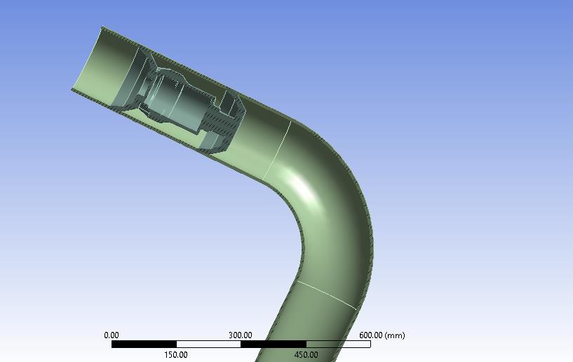

      I'm using static structural to simulate a problem which consists of a part. The part has two rubber-like cups attached to it at some distance in the body itself. This body (and the cups) need to move inside a pipe axially with the two cups contacting the inner surface of the pipe. Now, the pipe has a certain wall-thickness and the cups are CAD modeled to the outer diameter which (in reality) will help create a sealing for pressure to build up and push the part-body forward inside the pipe.
      Basically, there is penetration between the cup and the wall thickness of the pipe. First, how do I resolve this and establish a contact that will enable me to solve this problem?
      Second, I have these cups modeled to a hyper-elastic behavior by inserting a command which basically over-writes material and considers rubber-like behavior but I have no idea if I'm doing this right. The part in real is SS, with cups that are of Polyurethane.

      Hello Peter.
      Firstly, no I wasn't lucky with the solve using the first method you suggested.
      Secondly, can you please guide me through the second method using contact step control. I tried but I could not make the problem converge the way it would in reality.
      I am attaching a cross-section view for your reference.
      Please guide.
      Please reply with the version of ANSYS you are using and after you post the reply, use the Attach button to upload an Archive .wbpz file so I can look at your model.  The file size must be < 120 MB.  Delete the mesh if it is larger than that.
      Do you need this device to be pushed around the bend in the pipe?
      Another method is to flare the pipe out to a larger diameter and have the device begin with the first cup just tangent to the flared out section, and use an axial displacement to put the device into the pipe.
