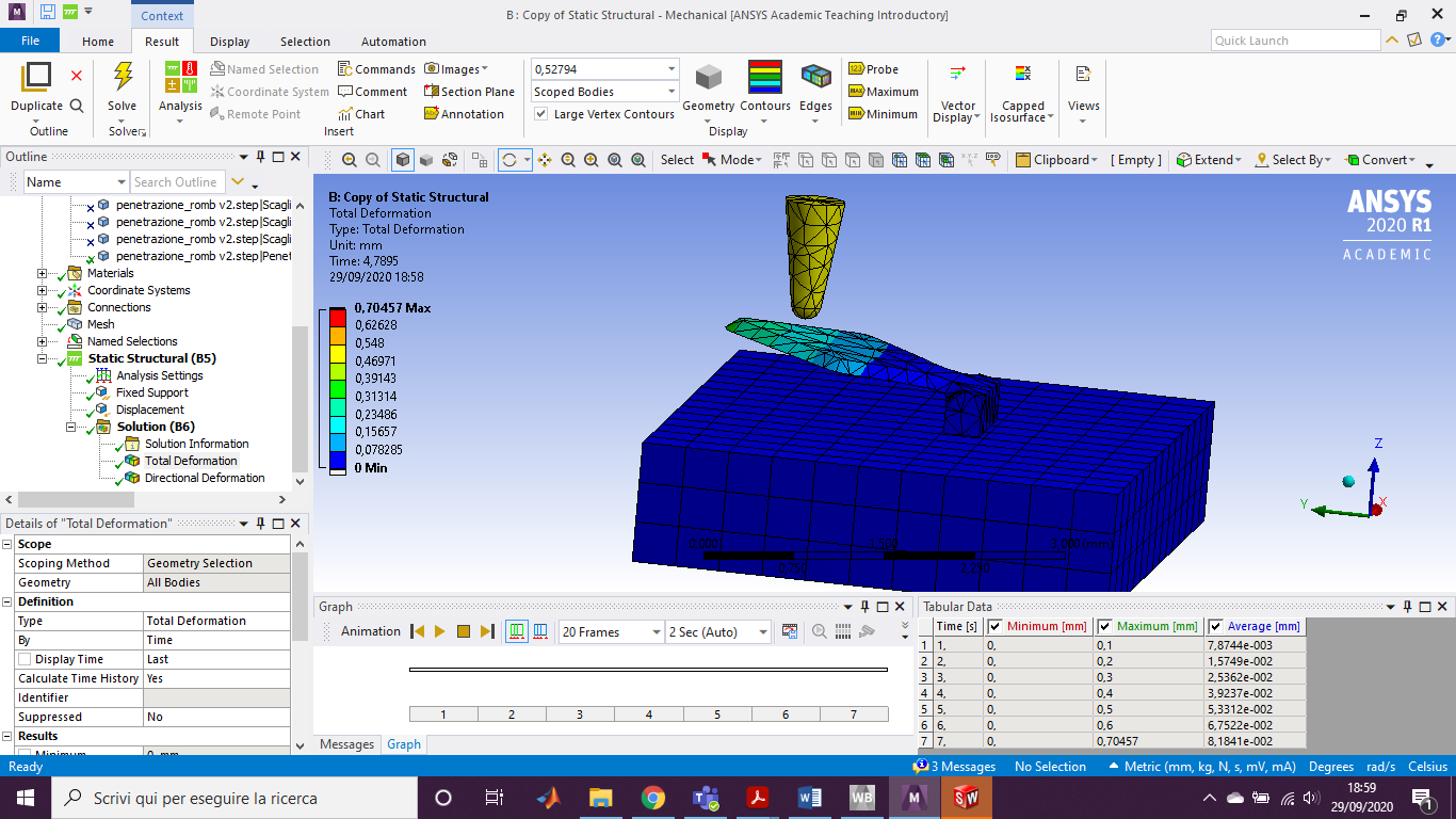

I am working on ansys workbench where I am doing a static structural analysis, made of a beam with a scale on it and an advancing indenter.
I don't understand why the scale inflects even before contact with indenter
September 29, 2020 at 6:31 pmJJ_Thompson
SubscriberWhat is the connection between your scale and the base rectangle ? Are you using the Lagrange multipliers for contact? nIt will help if you can show you contact settings , connections and boundary conditions. nSeptember 29, 2020 at 7:02 pmfrancesco03
SubscribernThere was a little bug.n I worked with large deformation ON, so I decided to turn OFF generate the solution and then refresh with ON.nThat's all.nThanks a lot, anyway.nnViewing 2 reply threads- The topic ‘Contact Problem’ is closed to new replies.
