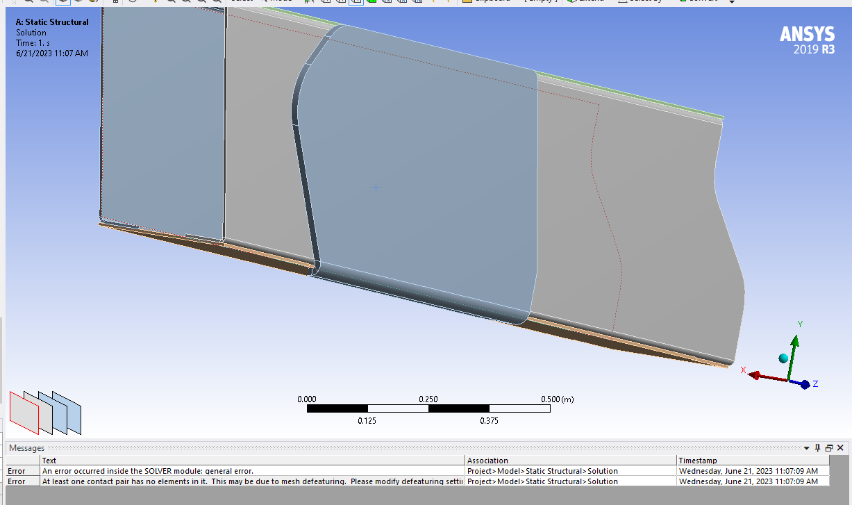

    • ehsan tolu
      hello every one. I have the same problem in ANSYS mechanical,
      i red all replies and do it step by step.
      I changed automatic mesh defeaturing to no  , but the result was same
      Also I Set the variable "contactAllowEmpty" to 1
      but still the problem appear.Could you direct step by step to be able to find the mistake?
    • ehsan tolu
      here is the photo for the related errors
