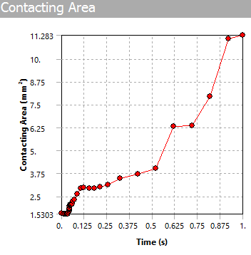

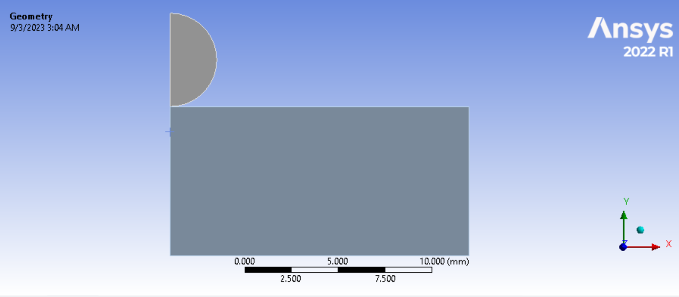

SubscriberHi John,
After finishing the simulation on a contact problem what steps should I take to get the contact area? Where do i find the graph like the one presented above.Â
