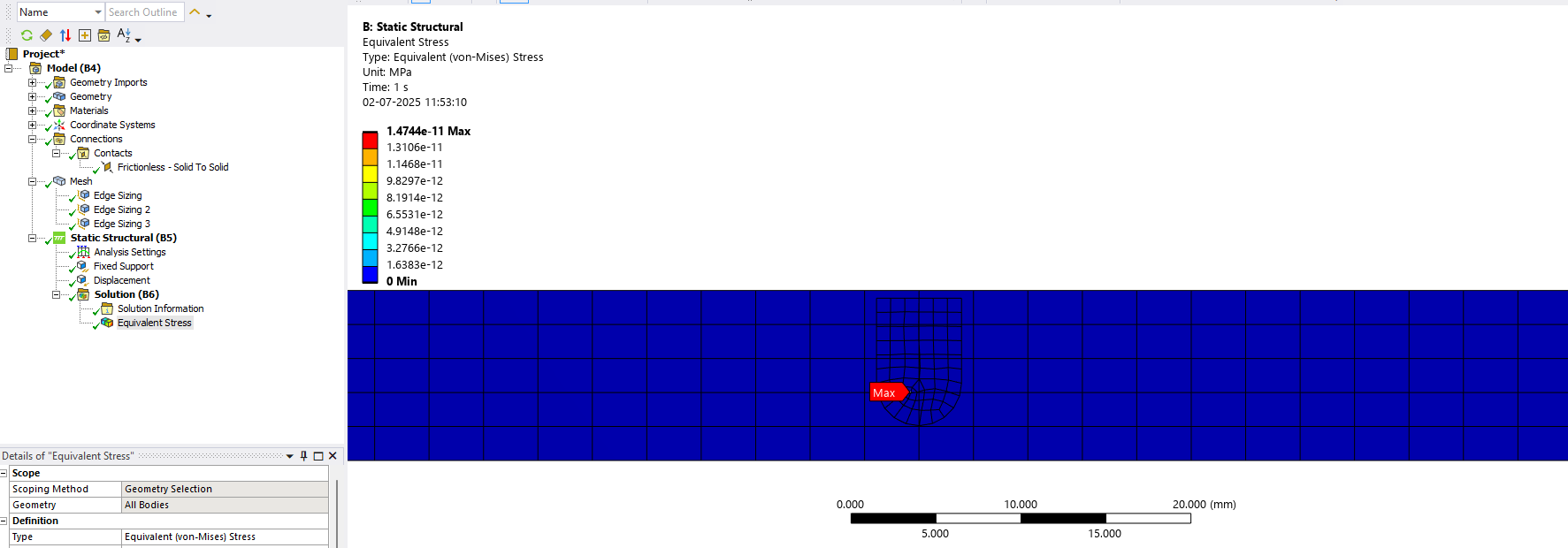

        I thought of solving the same probem in Workbench. I did so. But here is the result of it. I have given steel to be the material for both the bodies.
        I have given a displacement of -0.1mm in the Y direction.
        What I am not at all able to understand is that why is the plunger travelling roughly 8mm downwards ?

      1. Contacts work best with similar element sizes on both sides. While the target side can have larger elements in some setups, such as sliding, your "target" elements are many times the size of the elements on the plunger side, which I assume is your "contact" side. If not, it should be.
      2. As Erik Kostson wrote, you will need small time steps. You need to make sure time steps are small enough to capture the instant of contact within the pinball radius to detect contact. You may think just increasing the pinball radius woud allow this with larger time steps, and it can help a little, but it's most important to use a small time step to get that contact instant. Using a large pinball radius can have some strange effects such as contact occuring and bodies deforming while a gap is mainatined between bodies. Also, you wrote that you set a contact offset of 0.1, and this model does not look appropriate for any offset prescribed.
    • mjmiddle
      The plunger is most likely intersecting because your time steps are too large, so it misses the time of impact. You can set the time stepping in the Analysis Settings.

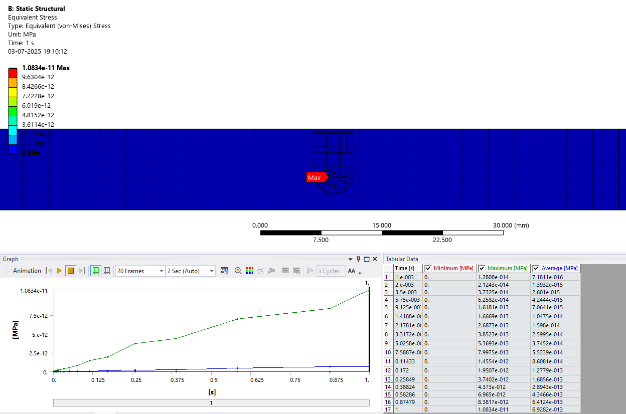

      • vighnesh.nandavar
        Hey,
        I am actually running the analysis in the smallest time step of 1s
        The solutions shows a contact value of stress after the 2nd step. So I am guessing the computation is fairly done in the first substep.

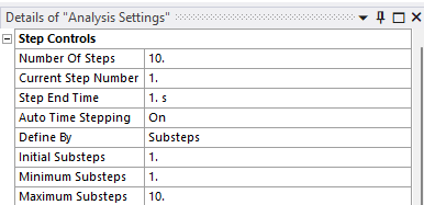

      Loadsteps are 1 second by default so a 1 second time for substep is very large. In fact, it means just one substep for the entire loadstep. Try initial substeps of 50 or 100. If that doesn't work, try 1000. 1000 substeps within a 1 second load step means 0.001 second for each substep or just the initial time step if you set 1000 for initial substeps.
      You can let it be free to make smaller time steps when necessary by setting an even smaller minimum time step. Using substep specification, as your image shows, you could do this by setting the maximum substeps to something like 1e4 or 1e5.

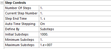

        Understood the concept of time stepping a bit better now
        I did the following
        The anslysis still ends the similar way
    • mjmiddle
      Maximum substeps of 1e7 is a little high. You could be waiting forever for a solution just to find it didn't go right. You are alwasy free to press the interrupt or abort button.

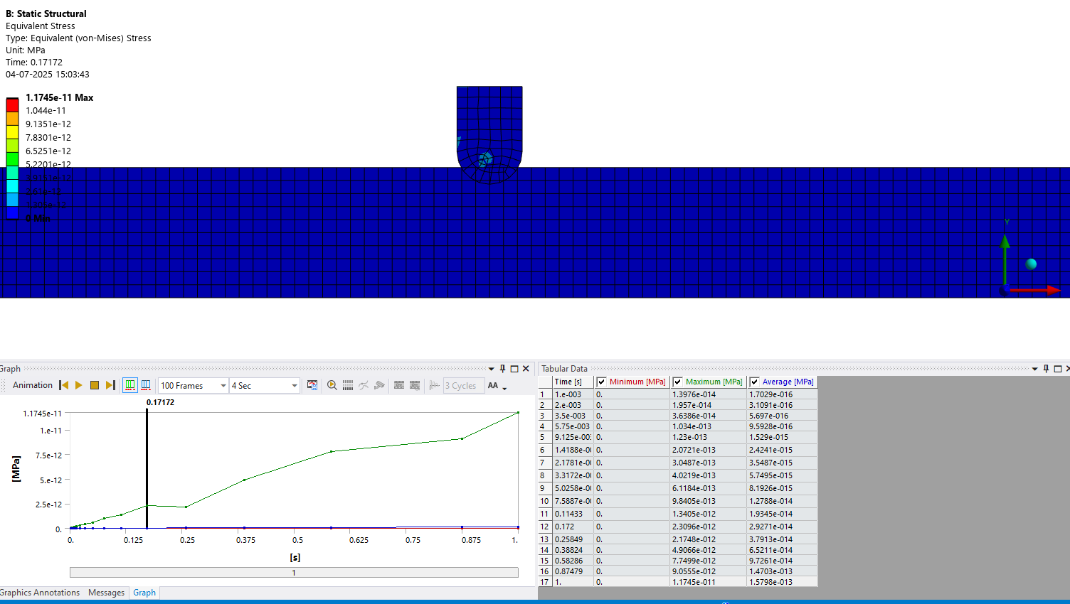

        Actually I too thought that the solution would take forever when you mentioned 1e5. But also with 1e7, it takes just around 10sec to finish computing.
        I have tried to a get a close match to the element sizes for the contact and target bodies and yes, the bodies are rightly chosen. I just cross verified them.
        When I run the animation, the slope at 0.1712s shows a small change in the colour contour. However that is mostly indicating that the value if stress is slightly higher. Even when I look at the slope, there isn’t a dip that is helping me conclude there might be a contact (let me know if my thoughts are wrong here).  By the end of the analysis, the plunger stays inside as in previous.
        Isn't displacement supposed to work like how we suggest? Shouldn't it just travel -0.1mm and perform calculations for this samll distance ? Why would it sink all the way down ?
    • mjmiddle
      Sorry, somehow I missed it was stress you were showing, not deformation. Those low stress numbers are just noise.
      If you intended the displacement load to be less, then maybe your result images are showing a scaled result. If not, then you must not be aware of the size of your model or the units.
      Try setting a contact pinball radius so the diameter is a bit bigger than the contact element size. Try setting a normal stiffness factor of 0.1.

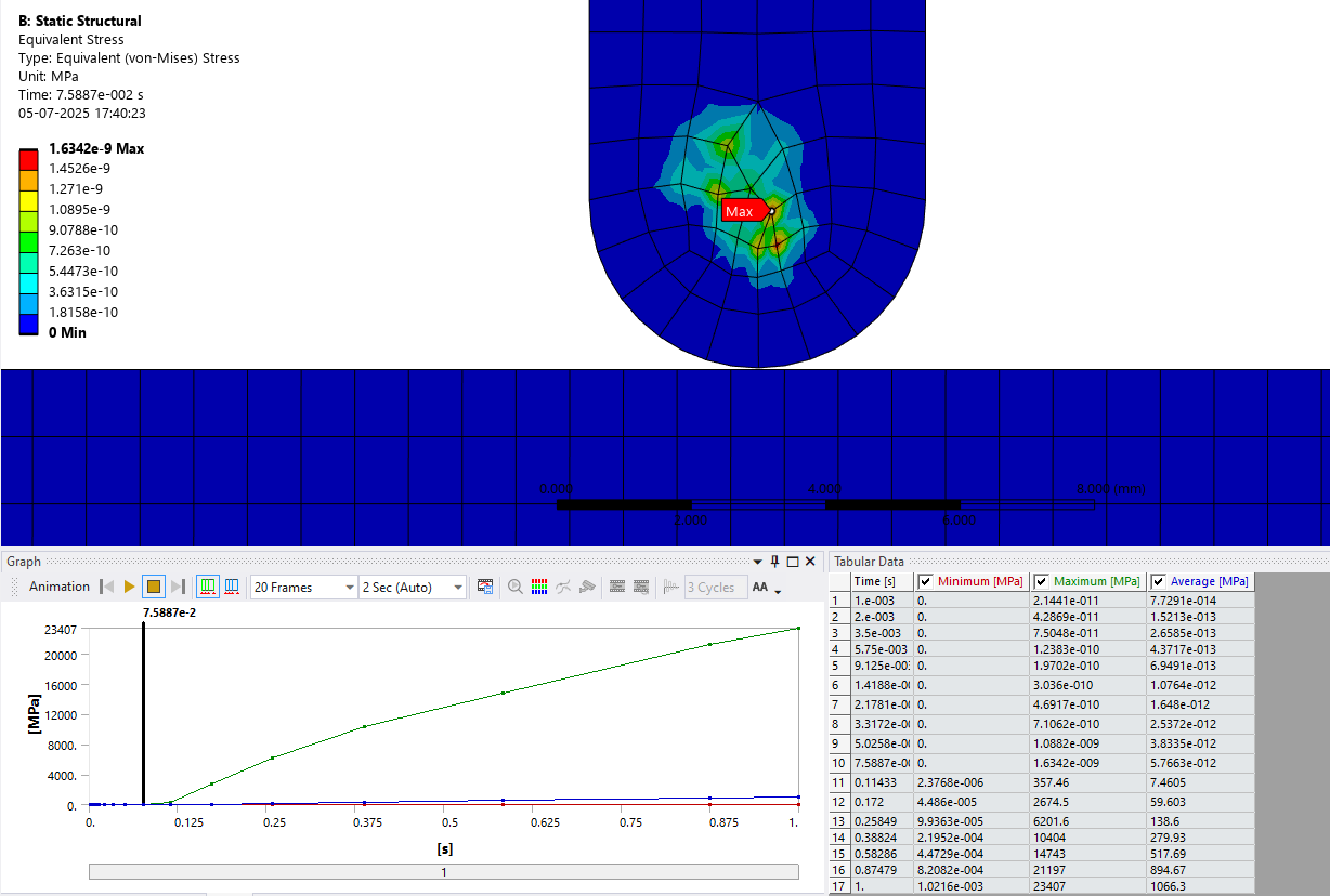

        My element size is 0.8mm. I now tried with 1mm pinball radius, 1.5mm radius and also auto detection.
        I now have new things that surprises me.
        Firstly, you are right, I did not notice the result's scale. I made it to True Scale now. The plunger thankfully doesnt pierce in now.  Also played with the stiffness value. The computer decided value yields the stress as shown in the screenshot while with the normal stiffness factor of 0.1, it gives a value of 23126MPa at t=1s
        However, if you look at the screenshot below, there is still that 0.1mm gap. So I tried increasing my displacement to -1mm. Well, the gap still stays the same.
        Why does this happen ?
        Also, if you look at the table for stress now, it shows a maximum of 23407MPa. The legend on the screen displays 1.63e-9 though. Now this confuses me.
        If you also look at the region of stress, it is not on the edge rather a bit higher. I am surely wondering why. I first thought it is may be because of a larger pinball radius. When I used the auto detect option, the radius was much smaller. So I could rule out that.
    • mjmiddle
      Your picture is at time 7.5887e-2 s. Please evaluate at 1 s if you want to see the 23407 MPa. With a low max stress of 1.6342e-9 MPa at such a small time, you are still in that range where it may be numerical noise, so the contour can look strange. I can't see that 1 mm gap in your model. Based on the measurement scale bar at the bottom, 1 mm is a lot larger than the tiny gap that may be in the picture.
      Be careful with a large pinball radius. It can cause some strange behavior such as a gap maintained when materials compress against each other. Use only as large as necessary. And lowering the contact normal stiffness can allow penetration that's not real also. So only use as low a value as you need to help convergence. Penalty based contacts, such as pure penalty and augmented lagrange always work with a little penetration. You can switch to normal lagrange if you want a very accurate contact interaction, but it's harder to converge, and often requires smaller steps.
      At this point, your biggest issue is the mesh size at the point they touch. You can see significant gap at the next node to the right or left of the contact point. You will have to do a bit of geometry modification if you want to carefully control the size near the contact point without making it small across the entire body. You could split the edge of both bodies at the contact point. Then set "edge sizings" in workbench meshing with bias so they start very small at the contact point and grow away from that (left and right).
      • vighnesh.nandavar
        My gosh. My baddd. Did not notice that. Thank yo so much. I just read the last step. Now I see the results.
        And the gap....it is 0.1mm. Very small.
        Roger that. Will also try the tiny mesh with bias.
