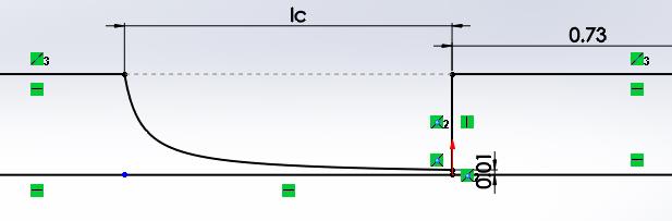

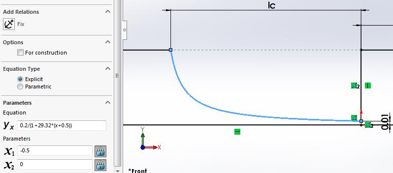

      Attached is a sketch of my hyperbola (equation y=0.2/(1+29*(x+0.65)). Can anyone tell me how to play with cone parameters to obtain this precisely, if possible? I already tried modify the angle of aperture of the cone and the angle of the plane of intersection, but couldn't obtain the desired curvature.

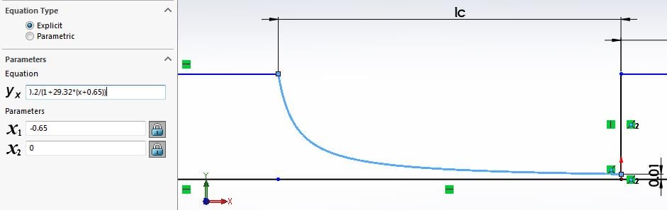

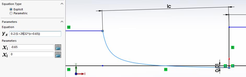

      I was able to open your SW file in SW2017 and I see the equation. Which coefficients of x do you want to make parametric?
      Your SW sketch is not fully constrained, meaning when I change the value of 29.32 to other values and back, it does not return to its original shape.
      Please fully constrain your sketch so that it cannot be ruined by parameter changes, and reply with a new zip file.

      A fully constrained sketch means there are no blue lines, it is all black. If you dimension vertically to one of the blue lines, it will turn black.

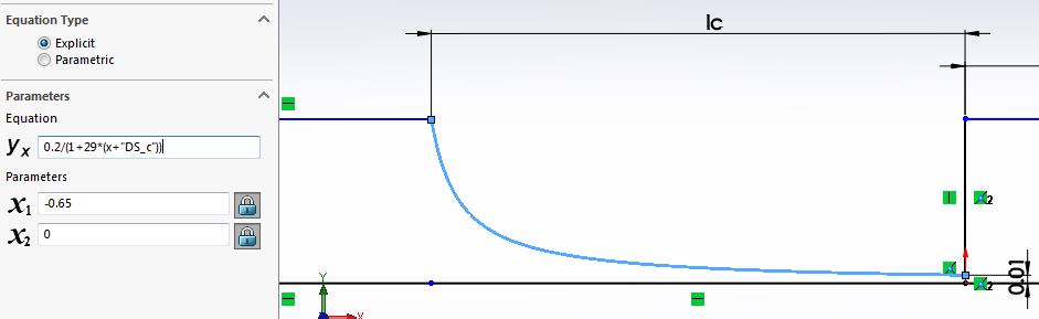

      I create a Global Variable "DS_c"
      Then I use that variable in the Curve Equation.
      Unfortunately, when I created a parameter for 29.32, this did not seem to update the geometry.

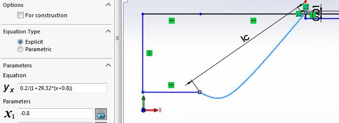

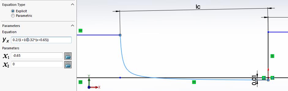

      There is an Ic dimension of 0.65 and there is a value of 0.65 in the curve equation and there is a value of -0.65 in the X1 field.  Do they all change together?  If I type in 0.8 for all, the shape of the sketch is shown below, is this what you want? I don't think so.
      If I change Ic to 0.5 and also the values in the equation curve and X1, the sketch looks like the one shown below.

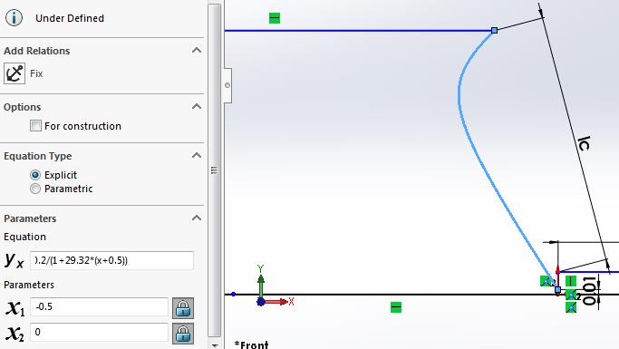

      Below I added a colinear constraint to the two top horizontal lines, see how the lines turned black?
      Now when I type in 0.8 for Ic and the two values in the equation, I get a very different sketch as shown below.
      Below is all values at 0.5 after the colinear sketch constraint was added. Do you see the importance of a fully defined sketch?
      I'm guessing that the above two sketches are what you want for the extremes.
      Please attach two SW part files (in a zip file), one at 0.5 and one at 0.8 to show me exactly what you want, so I don't have to guess.

      By the way, the global variable way looks more appropriate and I tried to do as follows in SW
      global variable "c"=0.65; global variable "a"=29 and equation given by
      y=0.2/(1+"a"*(x+"c") with x1=-0.65 (-"c" wouldn't work) and x2=0
      I'm not sure if I should give dimension to Lc in such case as it would be contrained? I give colinear constrain as you suggested and imported everything into Ansys Design Modeler but it reads 65 for "c" instead of "0.65", which is quite strange because all other parameters are imported correctly, and they are decimal as well (SW works with dots whereas DM works with commas). Any suggestion about that?
      Maybe if I could be able to parametrize the curve in SW with a and c and pass these two as parameters into Design Modeller, then direct optimization would be able to update the curve when giving a,c as input parameters?

      To do shape optimization with SW and WB, you want SW to have a global variable with a DS_ prefix that WB uses to look for the few parameters from the complete set in SW to use. In this case "DS_c" would be used. WB sends a new value for DS_c to SW, which updates the geometry and sends a new solid body back to WB.
