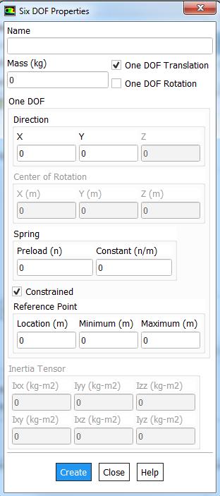

      I wrote the following UDF for a moving valve (6DOF).
      I want to add a constrained location, but I don´t find how to code this in the UDF.
      Thank you.

      I need it, in order to simulate the opening of a valve thanks to pressure forces. I prefer use an UDF as the interface of the 6DOF Properties.
      Thank you for your opinion. I just want to add a constrained location, so that the valve doesn´t move to far.
      Maxime

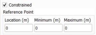

    • Max4
      On the interface of the Six DOF Properties, the Location is the distance between the origin of the XY axis and the center of gravity of the object?
      • Yagiz Guzelcan
        This is the local location of the the element you are interested in. You do not need to know the distance between the origin and the CG of the part.
