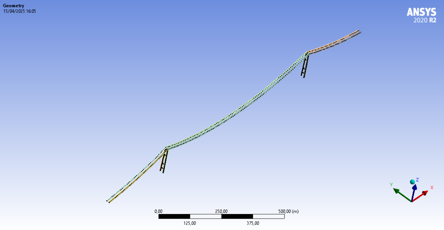

      Dear all. I am currently modeling a suspension bridge in Mechanical and I have run into some issues related to connections. For the sake of troubleshooting the problem, I have surpressed all other structures except for the main suspension cables and the tower structures. I figured that the problem must lie in the connections between the main cables and the tower structures. I have tried using Node Merge based on my previous experience in modeling a cable-stayed bridge, however the analysis remains unstable with the results showing solver pivot errors. If there's anyone who has had the experience in modeling a suspension bridge in Mechanical, I would like to ask for your advice. One solution I came across is to use the APDL command "CP" to couple the DOFs of the cable and the tower, however I wonder if I could do it through GUI which would be easier.

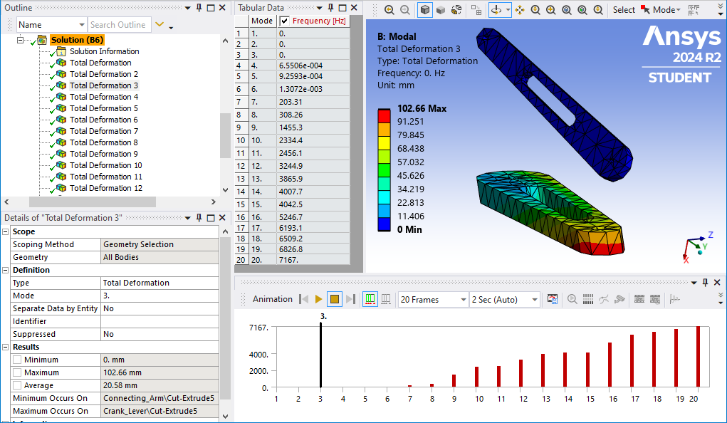

      Dear Audy,
      A diagnostic test that helps reveal if any component in an assembly is not connected to other components and if the structure as a whole has sufficient supports to ground is to run a Modal analysis. Drag a Modal analysis out of the Workbench Toolbox and drop it on the Model cell of the Static Structural analysis. Drag any Fixed Supports or other required supports from the Static Structural branch and drop them on the Modal branch in the Outline. Under Analysis Settings, change the Max Modes to find to 20 instead of 6.
      After the Modal analysis is solved, you can see in Tabular Data 20 rows. If any of the Frequencies show a value near zero, that is evidence of a part not properly connected. If the part is completely unconnected, there will be 6 modes with near zero frequency. Click on the Mode label to highlight all modes then right click and select Create Mode Shape Results. Under Solution, right click to Evaluate All Results.
      Click on each Total Deformation result with a near zero frequency. Graphically, the unconnected part will reveal itself. You can animate the result and the part will float around the fixed parts. In the Details window, the name of the part with the maximum deformation will be given.

        Thank you for your suggestions Peter. I checked that the cables are meshed using LINK180 element with tension only behavior. I managed to do a successful static analysis by creating coupled remote points between the cables and the towers and using the INISTATE command to give some level of pretension force to the cables.

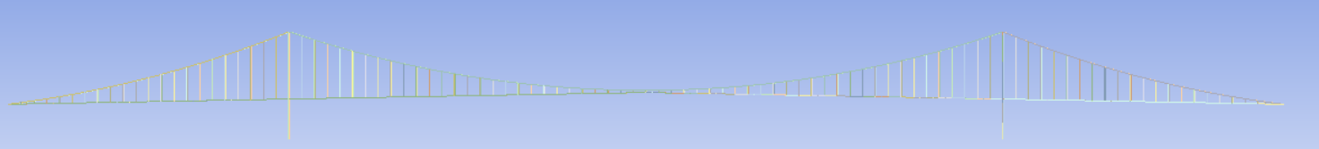

        My next step will be to connect the main suspension cables to the deck using suspender cables. If I may ask one more question, what do you suppose to be the most efficient way to connect the suspender cables with both the main suspension cables and the bridge deck? Can I use Node Merge in this case or should I use the coupled remote points as suggested by Akshay?
      It's going to be less work to use Node Merge so try that first.
    • 35020306
      I’ve tried connecting all the elements with Node Merge and I have managed to do modal analysis successfully. However, when I tried to do Static Structural analysis, the analysis gave the following error messages :

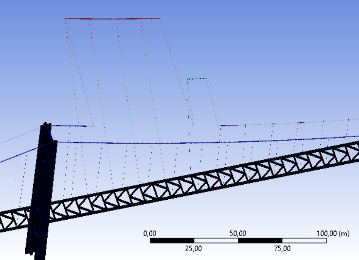

      The total deformation at the end of the analysis gave the following results:
      I wonder if this was caused by the cable not connected correctly.
      Yes, it looks like the cable is not connected correctly. Please show the results of your Modal Analysis.
