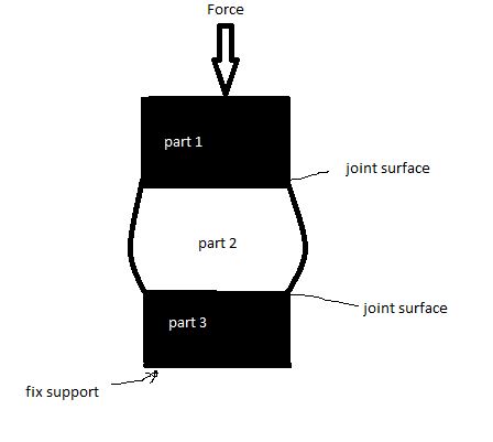

      Hi, I want to perform an analysis for assembly and I am confused which toolbox should I select? I am attaching a photo of the boundary condition to understand my problem.
      Drag a Static Structural analysis system out of the toolbox for this assembly.  That system has Engineering Data where you select or create the materials you need. Then open the Geometry editor, SpaceClaim, where you open the parts made in another CAD system or draw the parts from scratch, then open the Model environment which starts a program called Mechanical where you can define the Fixed Support, the force and the bonded contact between the parts. Mesh, Solve and finally look at results under the Solution branch.
