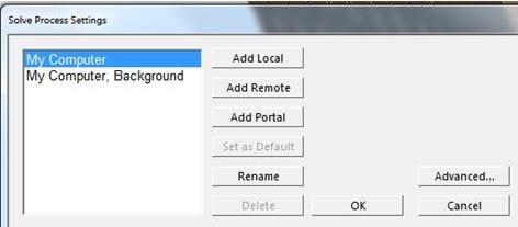

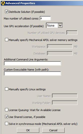

      In Mechanical, Tools, Solve Process Settings..., My Computer, Advanced...
      Though you are in a particular model, it is a setting for the computer, not just the model you are in, so it will persist for all other models.
      You can repeat on My Computer, Background if you submit for Background solve

      You don't see a list like this in Mechanical, Tools, Solve Process Settings?

      Hi Niresh, here are the screen snaps from start to finish. You first have to open any model in Mechanical.
      Click Advanced...
      Select My Computer, Background
      Click Advanced...
      Peter

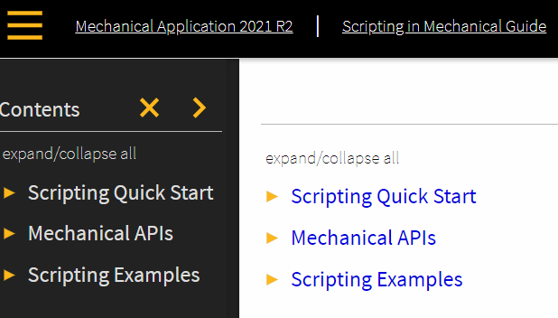

      Despite setting all the relevant command lines in Mechanical APDL when it is run in batch mode it won't use more than two cores. It's absolutely frustrating as ANSYS doesn't provide much if any information on workbench scripting.
      KartiSinghFreeman
      ANSYS does provide information on workbench scripting, there is a whole section in the ANSYS Help on that topic, complete with examples!
