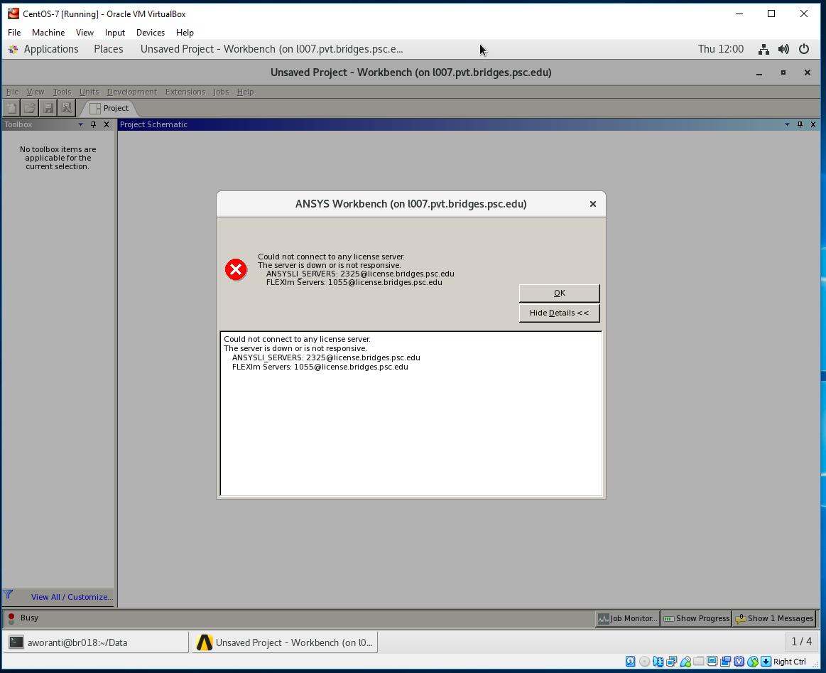

         Please, kindly advise on this error in the pic below.

      Is the license server on that license.bridges.... machine up and running ?
      If so, from the machine that has this error, try telnet to license server via port 2325 and see if that works.
      telnet 2325
