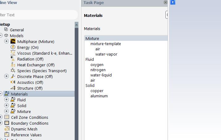

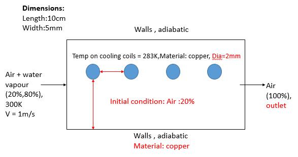

I am trying to simulate the condensation of water vapor from the air using eulerian mixture and condensation model . Below is screenshot of the domain and physics I have chosen

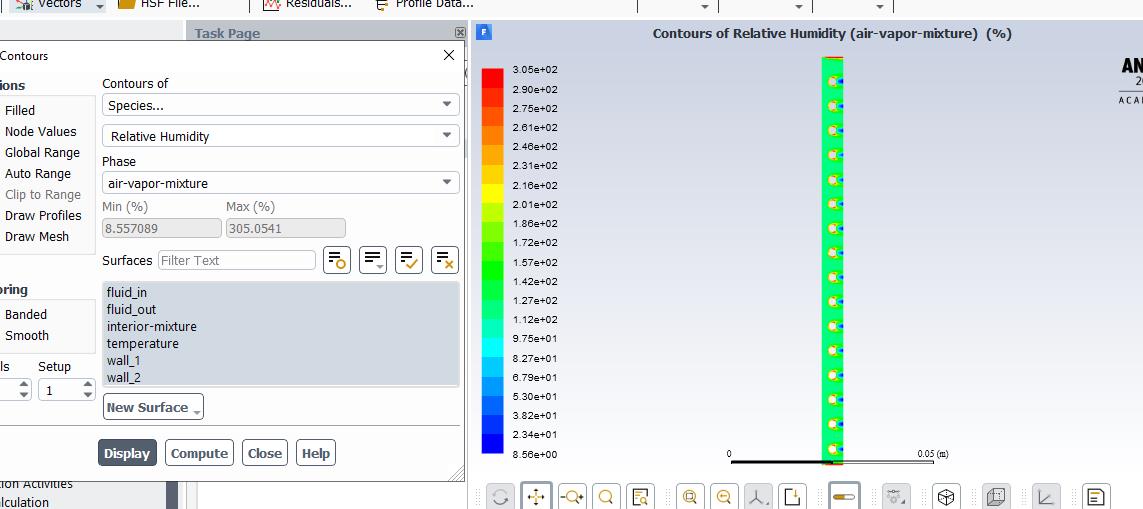

I dont understand why RH% determined by fluent is greater than 100%. Have i put in some absurd values anywhere here?
B.Cs
Inlet: Air with 80% RH, velcotiy = 1m/s
Volume fractions of water: 0.0315 based on calculated mass fraction of water vapor for 80% RH using RH formula
Outlet: Gauge pressure: 0 Pa
Backflow volume fraction of water vapor: 0
Walls of tube: 283K
Side walls: adiabatic

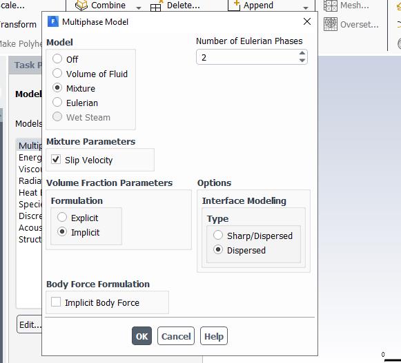

Multiphysics interaction

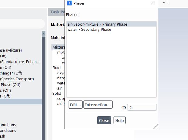

Materials defined - one phase is mixture of air and water vapor .other phase is water in liquid onlyÂ

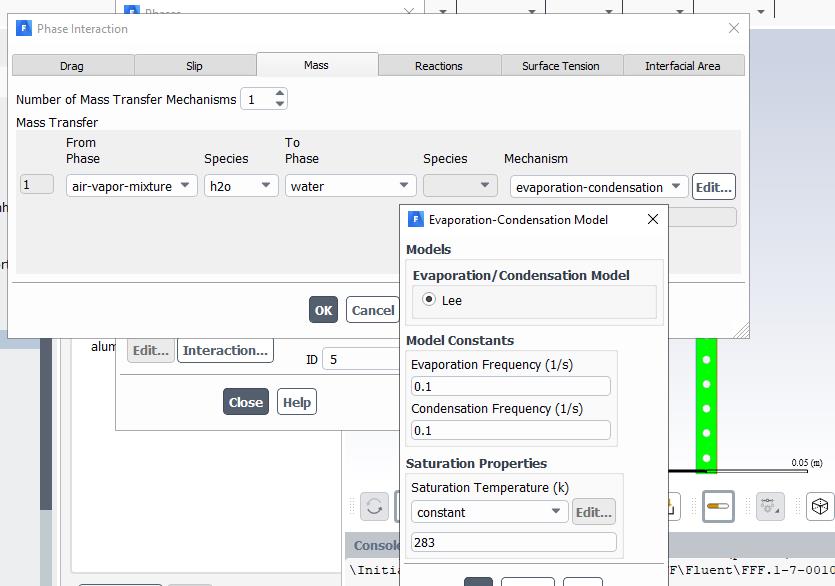

Condensation evaporation model setting
Results

Ansys Employeethe phase change model is wrong. You require partial pressure or concentration driven or you adjust the saturation temperature so that it matches rh equal to 100% -

Ansys EmployeeI mean the phase change: either you code your phase change, or you adjust temperature to match RH = 100 in each cell (UDF) or use species mass transfer apporach. REad the manual about that.

SubscriberSo do you mean to say that I need to create the condensation such that both materials are a species material? Also i just read the manual on this. They prescribe saturation temperature of 373K. Since this is evaporation saturation temperature and there is no evaporation in my domain, I changed my sat temp to 283K . Is this the mistake you are talking about?Â
April 7, 2020 at 7:25 am
Amine Ben Hadj Ali
Ansys EmployeeThe saturation temperature is not constant. water vapor will condense or evaporate whenver RH=1 is hitten and you need to understand what does RH mean.

You can use DPM model to model condensation there is an example in the customization manual. The UDFs examples are helpful (how to calculate RH) even for doing Eulerian run. Actually phase change should occur when RH =1. At that level partial pressure of water should be equal to vapor pressure. From that you deduce the temperature via inverse Antoine. -

SubscriberHey The Link doesn't work for me. Looks like it's broken To modify saturation temperature as function of vapor pressure, could I use the same physics I showed above but specify the saturation temperature in Lee model as function of vapor pressure using two UDF functions, one to calculate for vapor pressure and other to calculate for saturation temperature as function of vapor pressure? Will this be correct approach instead of using DPM ?

Ansys Employeeyes it might work. As you will need to do that anyway you can define your own RH based mass transfer using mass transfer udfs. -
