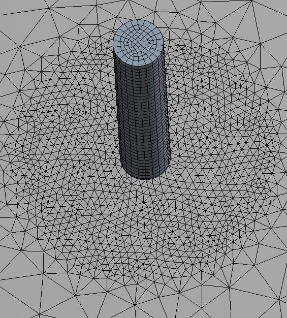

      I tried using the Cohesive Zone Model (CZM) for pullout. But I can not assign CZM Bilinear and CZM Exponential to my model. However, the CZM Separation and CZM Fracture can be assigned to the contact debonding.
      I read some other people work and they have used CZM for modeling pullout with zero thick interface, as also suggested by @bsista here. But within their model, they have used either CZM Bilinear or CZM Exponential, both of which I am unable to assign to my model. In addition, the Inter205 has been used mostly for the interface debonding.
      Please someone who has experience on CZM guide me on my mistakes. I intend to verify the experimental results.

      I am having the convergence issue in my model (attached here). I tried changing the mesh size and steps but did not work. Any suggestions to solve the issue?

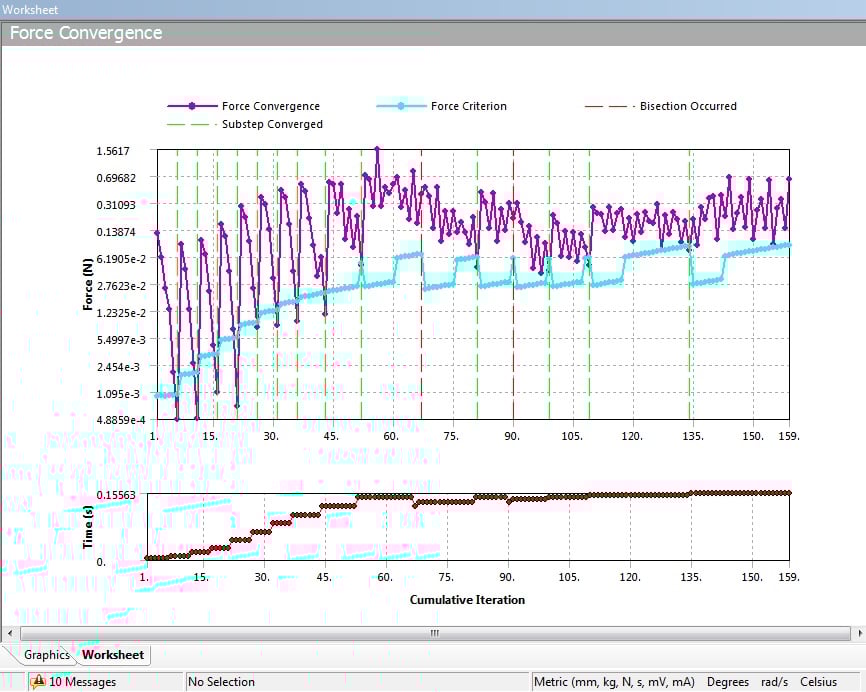

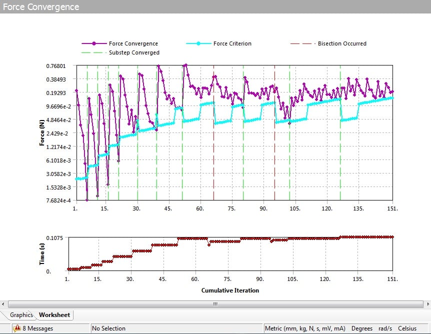

      Hi Jack,
      Disclaimer: I have never used CZM before.
      I downloaded your model and made a few tweaks to get it to converge on some early substeps.
      First, I changed the scope of your displacement from edge to face. For solid models, it is always best to apply BCs to a face, not an edge or vertex.  I also cut the displacement by half to 0.4 mm.
      Second, I added the command snippet neqit,50 to make sure more iterations were tried than the default 26.
      Third, I changed the Auto Time Stepping to have 200 initial and minimum substeps.
      Fourth, I requested 3 Newton-Raphson Residuals under Solution Information. Those plots are helpful so see where the convergence is failing.
      Here is the Force Convergence Plot for the first 100 iterations

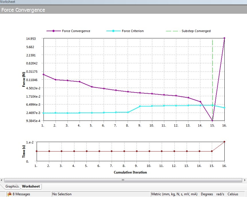

      Here is where it stopped.
      Here is the Netwon-Raphson Residual Plot.  It told me that the Maximum occurred on the Rod, so I am only displaying that below.
      The corrective action to make the solution progress further is to use smaller elements on the Rod.

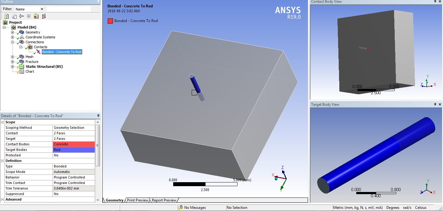

      I am trying to model pullout behavior (load displacement curve) of rod with concrete. Initially the rod is bonded with the concrete (embedded 1mm) and after some displacement (if the load doesn't exceeds rod strength limit) the bond is broken and then the frictional behavior starts which leads to either slip-hardening or rod rupture (if frictional stresses exceeds the load bearing limit of the rod) or slip-softening behavior. The boundary conditions are shown in the attached image (bottom of the concrete is fixed while displacement is applied on the free end of the rod).
      The bonded contact I have modeled is shown in here,
      The issues with CZM I have mentioned in my previous post are shown in the following images. My model is able to accept the CZM fracture and CZM separation but not the CZM Bilinear and CZM Exponential. Could you provide any suggestion regarding this issue?

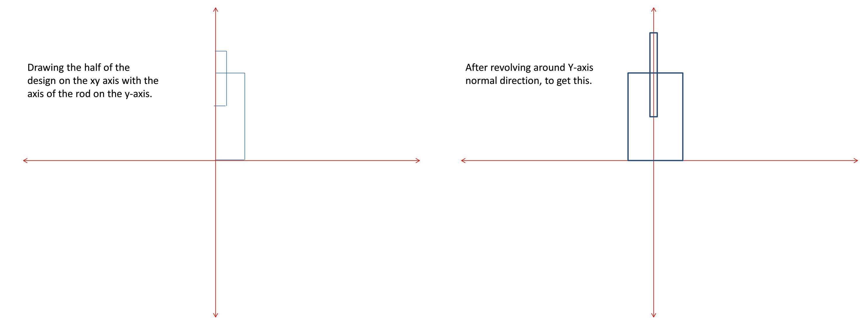

      I suppose by axisymmetry you mean to draw like the image shown below. Could you please confirm this is what you meant?
      If I put the axis of the rod on y-axis I ended up like shown in the image. I drew the half of the design on the axis and other half was done by revolving  .
      Yes Jack, that is kind of how you draw the geometry for an Axisymmetric structural model. But you show the concrete radial slice as a rectangle. You want a rectangle with a cutout in it as shown below to create a hole for the rod.  The rod is just a rectangle that you Add Frozen to have as a separate body.

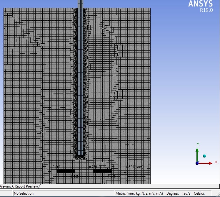

      Most of the residual errors were at or near the contact region. I modified the mesh size increased the body mesh density 1e-2. This took long time to process and at the end I had the following result.
      At the end again had the convergence problem but the solution information (attached) also said about the pc memory issue. I have ran out of options here to solve this problem. I tried different possible ways which I found in the community but still cant figure out how to solve it completely.  It would be helpful if you may guide me on the mistakes or if have time you make take a look at the model.
      Jack,
      MEMORY
      Your computer has only 4 GB of RAM and the solver can't reserve a large enough block of free memory to solve this model entirely within RAM. When this happens (and with a smaller mesh it will not happen), the solver switches to a different branch of code that uses the HDD to hold some of the solution while it works on solving. Since a HDD (or even a SSD) is orders of magnitude slower to access data than RAM, the total waiting time for the job to run is longer. In the example output file above, it took 7955 seconds, when it might have taken closer to 3062 seconds if you had more RAM.
      It's likely the motherboard on your computer is able to address more RAM, you have to check the specifications. If so, purchasing 8 GB of RAM and replacing the 4 GB of RAM will get this model to solve in less time. Note that memory cards come in many different types and you have to get the exact right type when you purchase 8 GB. Again, check the specifications.
      CONVERGENCE
      Your model has a displacement of 0.2 mm.  I'll bet there is nothing special about that number, it was just pulled out of the air (or somewhere else ) and you probably have no idea when interesting results will show up. What if all the interesting results show up after a displacement of 0.05 mm has occurred? Well that would be Time value of 0.25 s.  You have results going past that point, yet you haven't shown us any results. Why do you need the model to converge all the way to 1 s and have the rod end reach the 0.2 mm value?  It was an arbitrary number to begin with.
      I set the Minimum Substeps to 200 to prevent the solver taking big steps. Also, I cut the displacement down to 0.05 mm so the solution will converge to 1 s.  It is nicer when it finishes that way, so you don't have to deal with that last unconverged increment in the results. I made those two changes to the model I downloaded from your link above and it converged all the way to 1 s in 860 increments. That took 3.5 hours on a 12 core computer with plenty of RAM.  It will also take 860 increments on your computer, it will just take a lot longer.
      The early stages of debonding are shown in these results shown at True Scale, but the debonding is not complete.
      Make sure you set your Retain Files After Full Solve to Yes under Analysis Settings in the Restart Controls section.
      That way, when the solution finishes with 0.05 mm of displacement and you want to take the solution to 0.1 mm, you don't have to wait 3.5 hours to wait for solving up the the half way point. It can just restart from where you finished, but only if you made the above setting before you hit Solve.
      Hope this helps.
