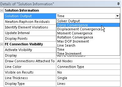

      i dont understand how you can plot the N-R force ?
      After the solve has finished, under the Solution Branch is a Solution Information folder.
      On the Solution Output line, select Force Convergence from the pull down.

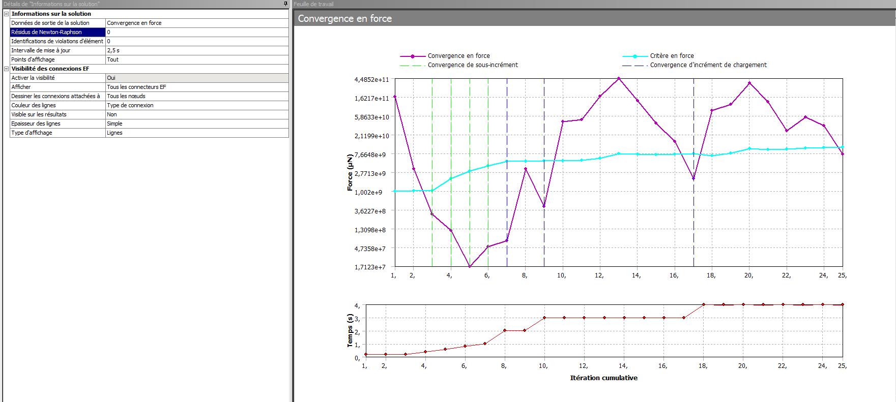

    • mahdi2019
      It looks like it solved nicely. What was the result you got and what result were you expecting?
