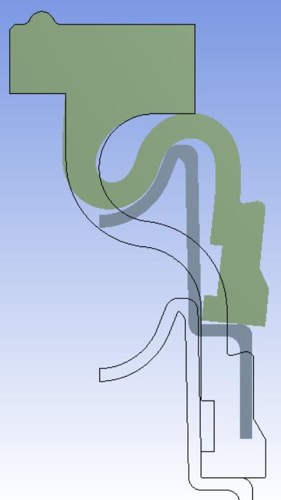

      Since the rubber cup geometry and the loads are axisymmetric, I recommend you convert this entire model to an axisymmetric model. An axisymmetric model requires a 2D radial slice of the geometry to be on the XY plane, with the Y axis as the axis of rotation and the slice to be on the positive X side of the Y axis.  If you do that, and use the single spring element for each spring as described above, you can just keep the Rubber and the Holder.  The rightmost face of the Rubber in the image above can be considered Fixed.  The Holder can have frictional contact (harder to converge but more accurate) or bonded contact with the Rubber.  The cup is left out of the model. Instead, the two nodes that represent the ends of the springs that touch the cup are given displacement inputs to compress the assembly.

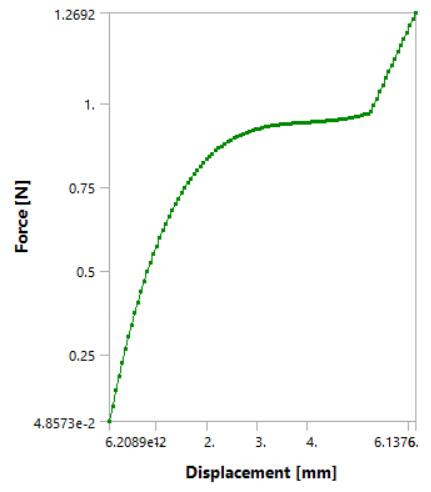

      Here is an Axisymmetric model of the Rubber and the Holder being compressed 6 mm and the Reaction force to do that for a generic rubber material whose properties I made up.  You have to get your own hyperelastic material properties.

      Thank you for your patience and help.could you please upload the model which you solve in ANSYS? I think i need to know the contact assumption you have used for the solved model. and could you tell me how the force displacement diagram is created? Thanks in advance

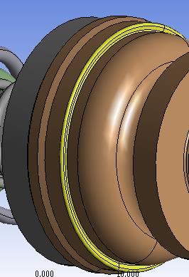

      And i have another question. i want to exert the displacements in two steps.First step compressing rubber and after that, fix the compressed rubber from the yellow part and continue compressing springs. is it possible? i used displacements in two steps, but i can not handle it correctly since the rubber is not in its the initial state.
      Uploaded the ANSYS 2019 R2 archive of the Axisymmetric model above. You will see the Chart object and the Details window for how the chart was made.

      The yellow part clamps the rubber to the holder by a radial displacement of the clamp. The clamp does this first, before any compression of the rubber boot in the axial direction. That would best be done by drawing a circle tangent to the rubber. Create a material for the clamp that has a Coefficient of Thermal Expansion.  Apply a Thermal Condition in Step 1 of the model and change the temperature by an amount that will cause the clamp to shrink onto the rubber.
