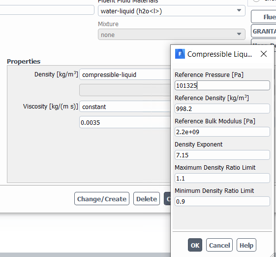

SubscriberHello,
Im performing FSI simulation (Fluent+Mechanical+System Coupling) and I tried to use a compressible density model for Water - to check whether it helps with stabilizing solution. However, I am getting a diverged solution. This does not happen when I use a constant density. I am using the same settings as default. I also tried to use a Density Exponent equal 1.0 - with the same unsuccesfull result.
My settings are in attached image. In Fluent I am using an operating pressure (Physics->operating conditions) equal 101325 Pa, and Referrence pressure (set in Refference values) equal 0 Pa.
What I am doing wrong?

Based on Tait's relation, have you estimated and compared the value of density with that of regular liquid water at 1 atm? You should be able to find the relationship here in the link below.
8.3.4. Compressible Liquid Density Method (ansys.com)
Karthik
March 7, 2022 at 2:47 pmdestroy
SubscriberI used the default values from the Fluent database which I believe are proper..
According to the equation - when p=1 atm, K/K_0 = 1 and rho = rho_0 - but I dont know how that would help me

SubscriberOK I checked that this variable density works with the fluent standalone, with the same Fluent case. Works even when the motion is present (imposed via UDF cg_motion)
It does not work when I use a coupling of Fluent and Mechanical. Dont know why.
it diverges with the second coupling iteration, that is, if you are not familiar with System Coupling - after the second Fluent solving. Residuals are pretty good after the first Fluent solving. Then Mechanical calculates displacements and Fluent works again and diverges. This not happens with the constant density.
