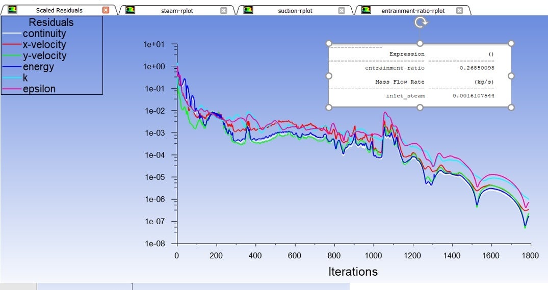

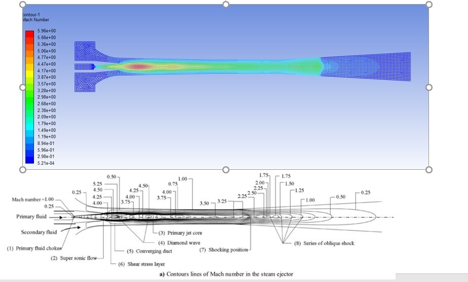

I am trying to simulate a flow of steam ejector as a 2d Axisymetric based on this paper https://www.sciencedirect.com/science/article/pii/S1290072912002098, but I have an error "divergence in AMG solver" in the begining of calculation
currently, I am using Ansys R19.1
I read about this error in ansys forum (/forum/discussion/23920/problem-with-tutorial-in-fluent-divergence-amg-epsilon-for-ic-engine-cold-flow-simulation/p1) but still doesn't work

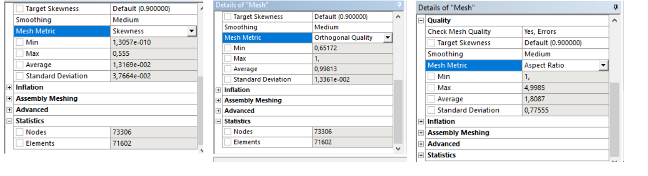

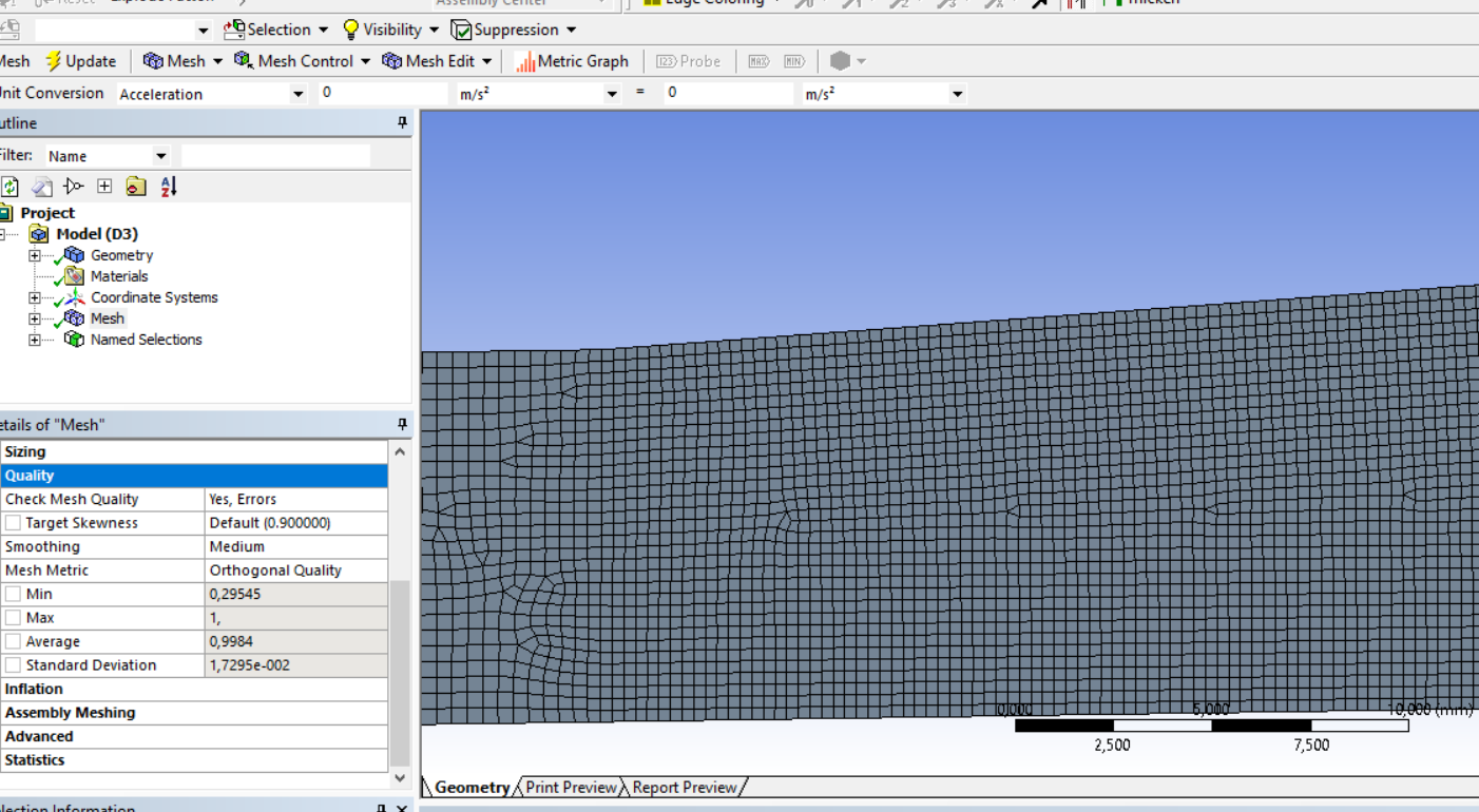

I checked my model,
the average orthogonal quality ,skewness quality, and aspect ratio is pretty nice, but I have problem with the small curvature of nozzle throat, so the max point of skewness occur in that area
May 17, 2021 at 9:43 amAmine Ben Hadj Ali
Ansys EmployeeIs it possible to ramp the pressure at outlet down by starting from high value? Also think about using transient solver at first.
May 18, 2021 at 1:01 pmRob
Forum ModeratorThe other thing to do is patch in the fast moving flow from the high pressure section. Using all pressure boundaries tends to make convergence more difficult and ejector flow is complex in that it's an entrainment flow system.
What Mach Number are you expecting in the throat? Pressure based solver is good to around Mach 2-3 so you may find that a better choice.
June 27, 2021 at 1:36 pmRahadyan
hi , thank you so much Rob for your answer
I really want to say sorry that I miss the notification, unfortunately, I haven't solved it.

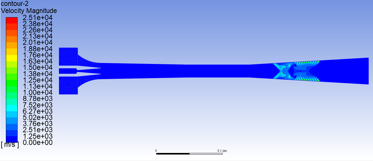

the Mach number will be unity in the throat and will increase up to 1300m/s at the nozzle outlet (based on paper). so the density-based model will be sufficient for this (based on paper)

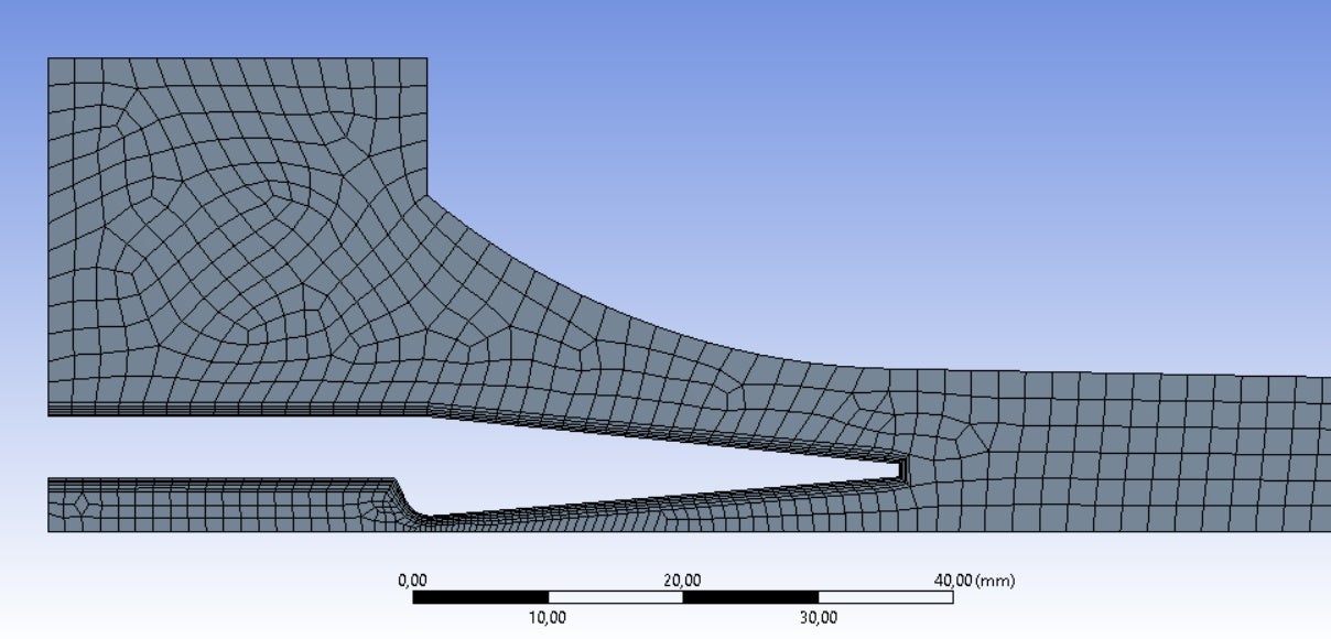

I don't really know why, but if my mesh is coarse (2000 element) the simulation goes well.
but when I increase up until 40000 like the paper said, the hot spot "excessive temperature" occur
would you like to give me an advice, thank you so much
June 29, 2021 at 11:06 amRob

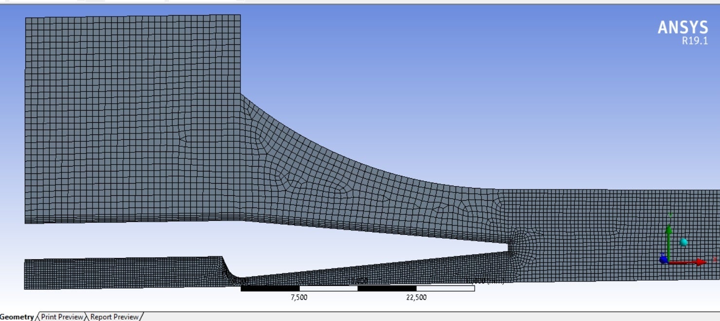

Forum ModeratorWith a coarse mesh you may be diffusing some of the peak temperature away to the solver is less accurate but marginally more stable. As you resolve the flow you may be seeing a more accurate solution and picking up more flow features. Are you increasing resolution in the entire domain or just where the flow gets more interesting?
July 1, 2021 at 8:05 amRahadyan
SubscriberHi Rob, Thank you so much for your question
I am very happy that my simulation works.
I guess it is due to the transition between each mesh. I do a Bias to ensure the transition very smooth
thank you so much
