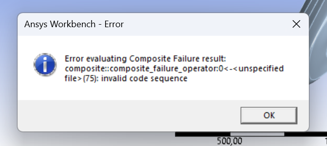

SubscriberHello! I´ve been having an issue every time I run a composite failure tool solution. Basically, I´m trying to run a total deformation solution and a composite failure tool solution, the first one is doing ok, I click solve and the software gives me coherent results, but when i try to solve the second one this error message appears saying "Error evaluating Composite Failure result:
composite::composite failure operator:0<-(75): invalid code sequence". I've tried to run it without any failure criteria and I've tried to change some parameters, the failure criterion and the numbers of plys, but I still get the same error message. This has happend in two different archives. Anyone knows how I can fix this? Â

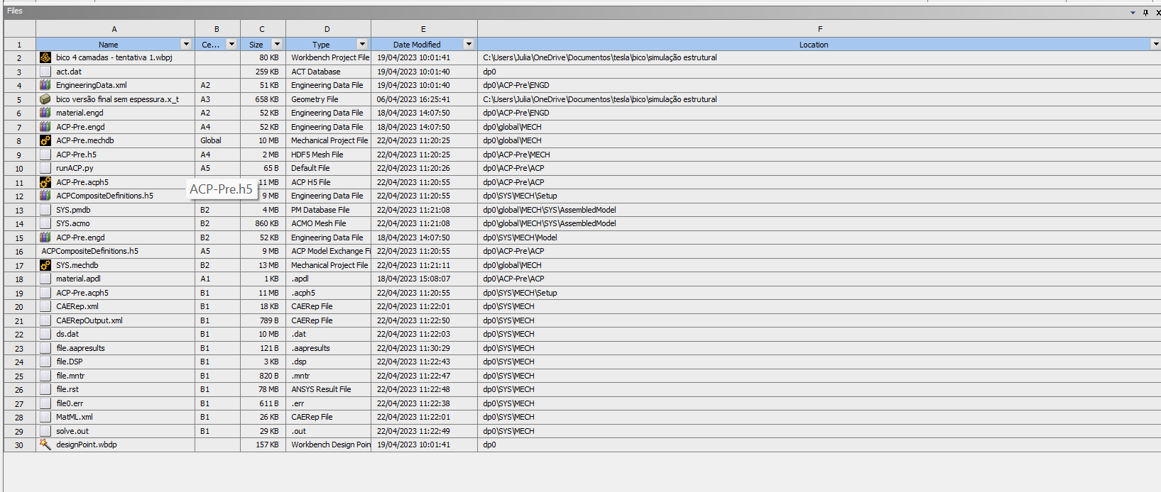

Also, from WB Project schematic, go to View -> Files and see if any of the files are missing. Missing files are listed in red color

SubscriberI tried cleaning the generated data in ACP Pre and updating the model again, but I'm getting the same error message. Also, it doesn't seem to be any missing files.Â

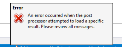

I checked the solution information and it says "Please review output or errors file (C:\Users\...\_ProjectScratch\ScrEED0\file0.err ) for these warning messages.", but I couldn't find anything.
