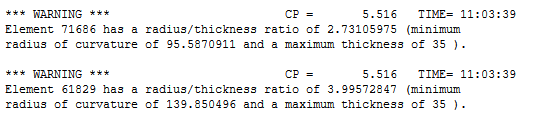

SubscriberHi, Im doing an ACP analysis for Carbon Fiber winding. I came across error messages as follows;

January 31, 2022 at 3:06 pmManish Dubey
If the initial shape of the model is curved, then theradius/thickness ratiois important because the strain distribution through the thickness departs from linear as the ratio decreases. Some shell elements, such asSHELL181andSHELL281, use an advanced element formulation that accurately incorporates initial curvature effects.
The curved-shell formulation is automatically disabled for excessively thick and curved structures with an r / t ratio below 5 / 6, where r is the radius of curvature measured at shell mid-plane and t is the total shell thickness.
For Shell181 elements (linear shell), you can use the advanced curved-shell formulation (Keyopt 5 = 1) and for this you probably need to set that Keyopt using MAPDL commands in a Command Object.
"When KEYOPT(5) = 1, the element uses an advanced formulation that incorporates initial curvature effects. The calculation for effective shell curvature change accounts for both shell-membrane and thickness strains. The formulation generally offers improved accuracy in curved shell structure simulations, especially when thickness strain is significant or the material anisotropy in the thickness direction cannot be ignored, or in thick shell structures with unbalanced laminate construction or with shell offsets. The initial curvature of each element is calculated from the nodal shell normals. The shell normal at each node is obtained by averaging the shell normals from the surroundingSHELL181elements. A coarse or highly distorted shell mesh can lead to significant error in the recovered element curvature; therefore, this option should be used with a smooth, adequately refined mesh only. To ensure proper representation of the original mesh, a nodal normal is replaced by the element shell normal in the curvature calculation if the subtended angle between these two is greater than 25 degrees."
Also, you can use SOLSH190 for simulating shell structures with a wide range of thickness (from thin to moderately thick). The element possesses the continuum solid element topology and features eight-node connectivity with three degrees of freedom at each node: translations in the nodal x, y, and z directions.

March 15, 2022 at 6:12 amsrutheesh
SubscriberDear
Thank you for your response.
Sorry, I took long to reply as I was busy with the project.
The link you provided is useful information and thank you for the same.
