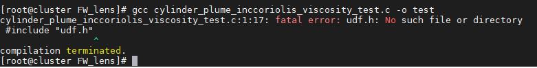

      Thanks for the suggestion. I believe I did what you asked. I deleted anything before the "include "udf.h" line and then hit enter for a few lines to move the text down. (I also tried with returning the text to the first line after doing so.)
      When compiling directly from the Linux command line this is the error I received.
