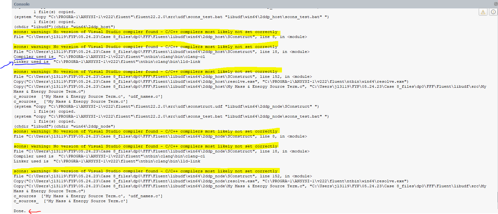

      I would like to compile my mass transfer UDF but I do not have Visual Studio installed on my computer, therefore I am using Fluent's built-in compiler. The image attached shows the message that appears in the console when the library is building. Has my mass transfer UDF been compiled correctly or is it necessary for me to install Microsoft Visual Studio?
    • Federico
      Yes, your UDF should be compiled correctly. If Fluent determines that you have not installed a compiler on your computer, a built-in compiler (Clang) will be used. This built-in compiler comes as part of the Fluent installation.
