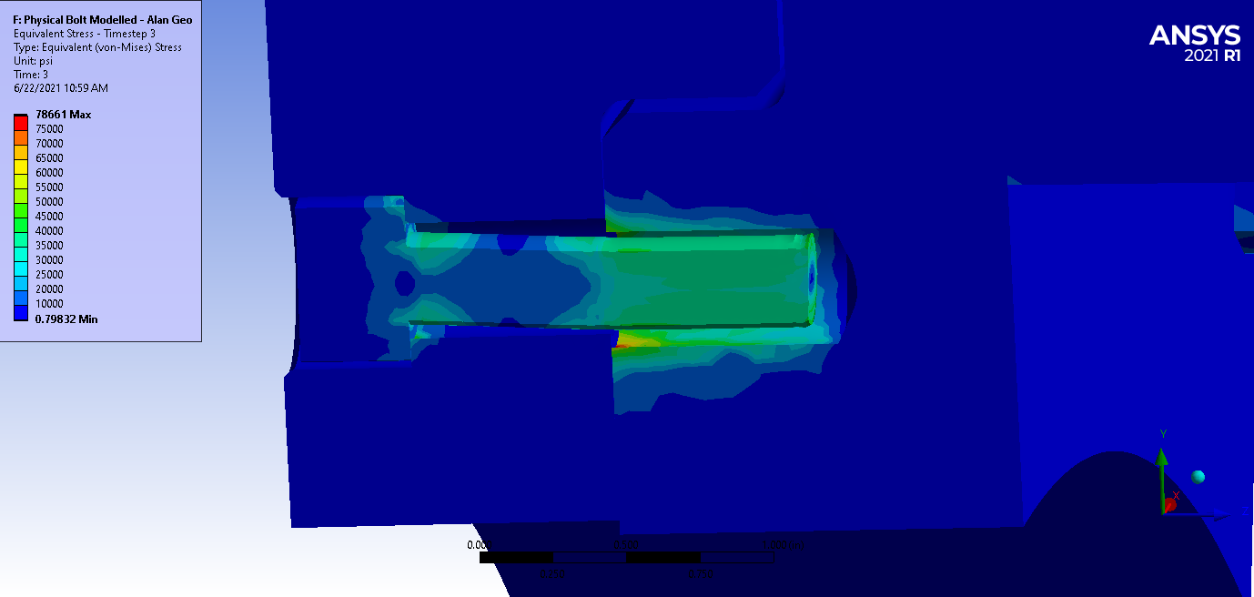

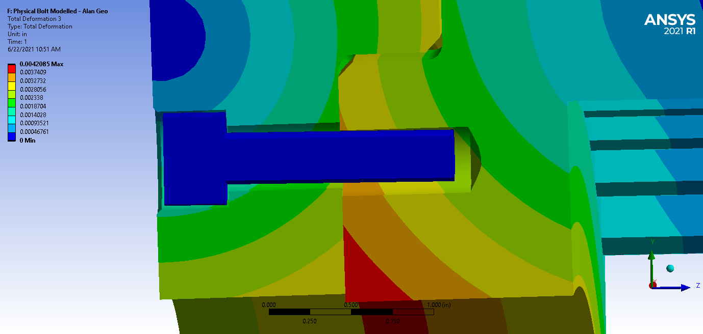

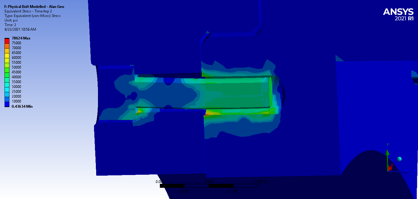

Thanks for the explanation, I've learned something new from you! I've followed your instructions and my analysis is converging, but I believe I am calculating inflated stresses in time step 2 or 3 when I re-establish the bolt contact regions.
The bolt has been held perfectly still from the displacement constraint in timestep 1, and of course the two rings have skewed per their interference fit resolution. So in a sense, am I adding a pretension that is misaligned? I've attached some pictures that hopefully illustrate what I mean.
My other question regarding the modelling of the physical bolt is this: I've modelled the bolt using a shank diameter that represents the tensile stress area (A_t), so my bolt diameter is undersized from nominal. Would this cause issues with the contact elements assignments? I've increased the pinball radius and they seem to be working, however I'm you can see the presence of significant stresses in timestep 2 and 3 when I set the bonded contact areas to alive.
The above photo is timestep 1 - the interference fit is resolved and the bolt is completely stationary as intended. This displacement is exaggerated by a factor of 10 for plotting purposes
The above picture is the equivalent stress in timestep 2, the bolt is still restrained using a displacement constraint and the bonded contact areas are set to alive
This above picture is timestep 3 where the bolt boundary condition is removed.
