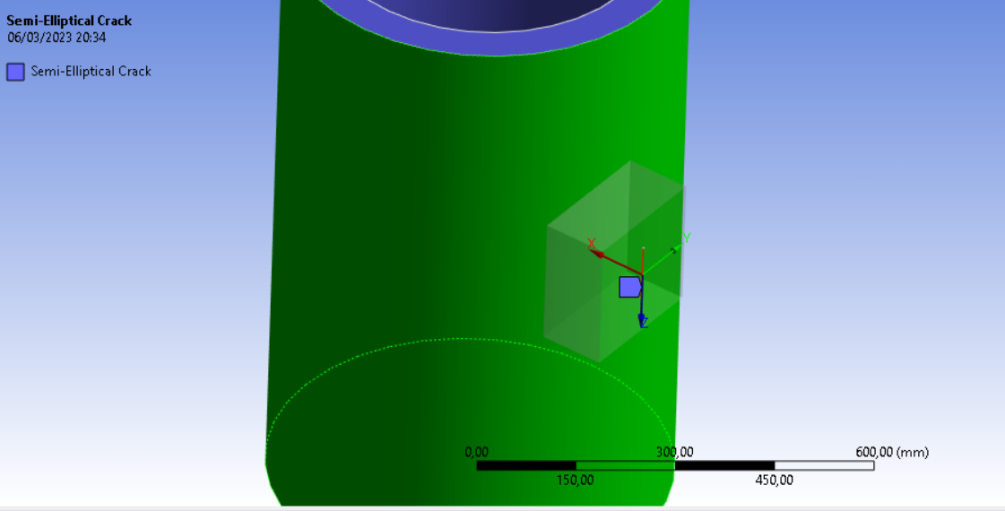

I generated a #semi-elliptical crack in a cylindrical #bamboo model. But since the crack needs to be aligned longitudinally to carry out the buckling analysis, I couldn't follow the basic requirements for the local coordinate system of cracks which is; the X-axis: towards the body, Y-axis: in the direction of the load, and Z-axis in the crack direction. In order to have a longitudinal crack, I adjusted the z-axis but the direction of the y-axis isn't where it is supposed to be, since the load would be applied from the top. I have attached an image showing the coordinate system for my crack generation. Â
I would really appreciate it if someone could help me through this.
Thank you in advance!

Forum ModeratorHi Divya,
Please see if the following posts help:
Fracture mechanic – cracks results interpretation (ansys.com)
Coordinating Coordinate Systems in ANSYS Mechanical - PADT (padtinc.com)

SubscriberHello Ashish,
Thank you for the reference. It was indeed helpful.Â
Although I have one more doubt. My task is not to simulate the propagation of the crack, but rather to generate a 3D crack( with some length, depth, and thickness) into a model and simulate the model to compression and buckling in the presence of that crack. I have tried generating using the Semi-elliptical cracking method.
Do you think it is possible to generate such a crack where one can know how deep and thick it is?
