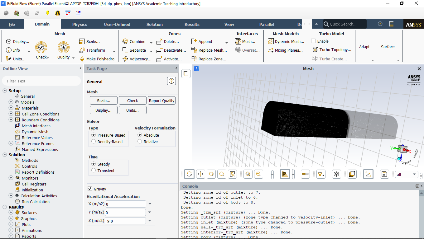

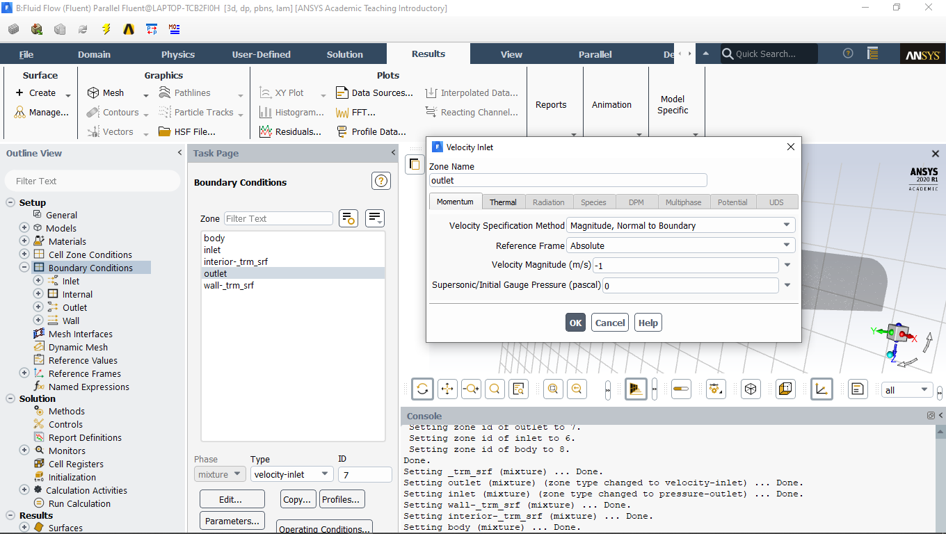

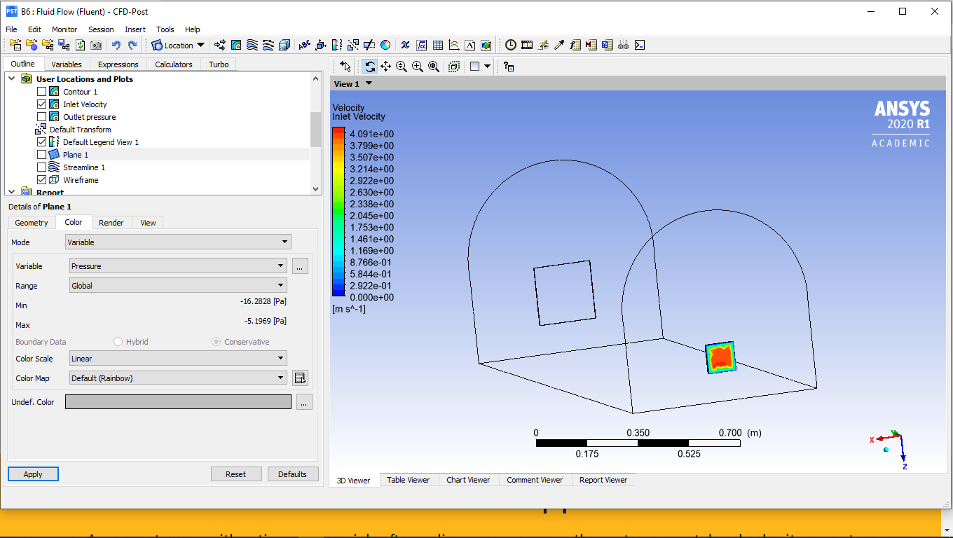

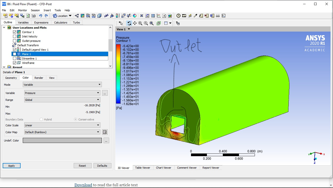

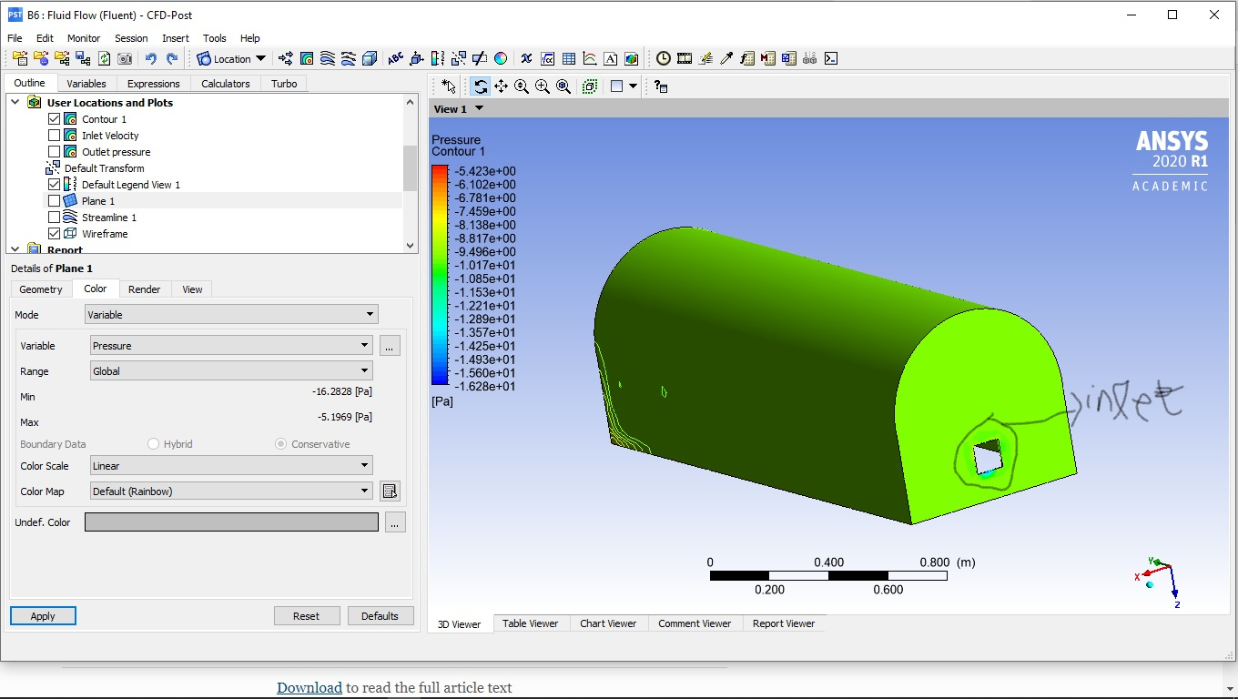

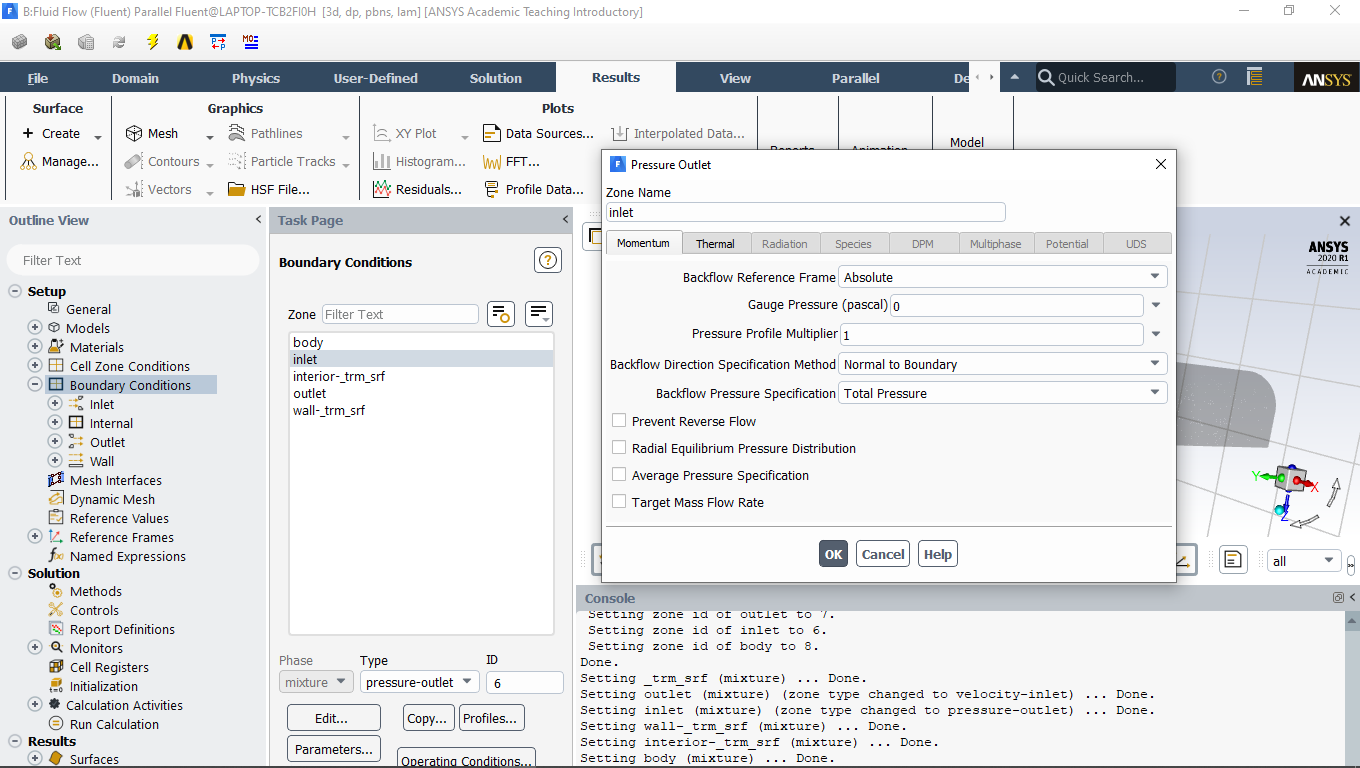

SubscriberI did as you guided me sir, but I am getting -10 Pa pressure even if I am taking a very less outlet velocity like 1m/s. I am attaching certain photos so that you get an idea about my simulation.nInlet velocity is coming around 4m/s.nThe main concern is that why the pressure is coming like -10Pa . I want attain a constant 101300 Pa which is only 25 Pa less than atmospheric pressure. nPlease help.n

Forum ModeratorIf you want -25Pa you may need to suck more air out, so increase the flow rate. You did read the manual section(s) explaining how the operating pressure worked didn't you?n -

Forum ModeratorWhy? If atmospheric pressure is 101325Pa what is the difference between -25Pa Gauge and 101300 Pa absolute? n -

SubscriberYes, I got your point . Thank you for your guidancen
