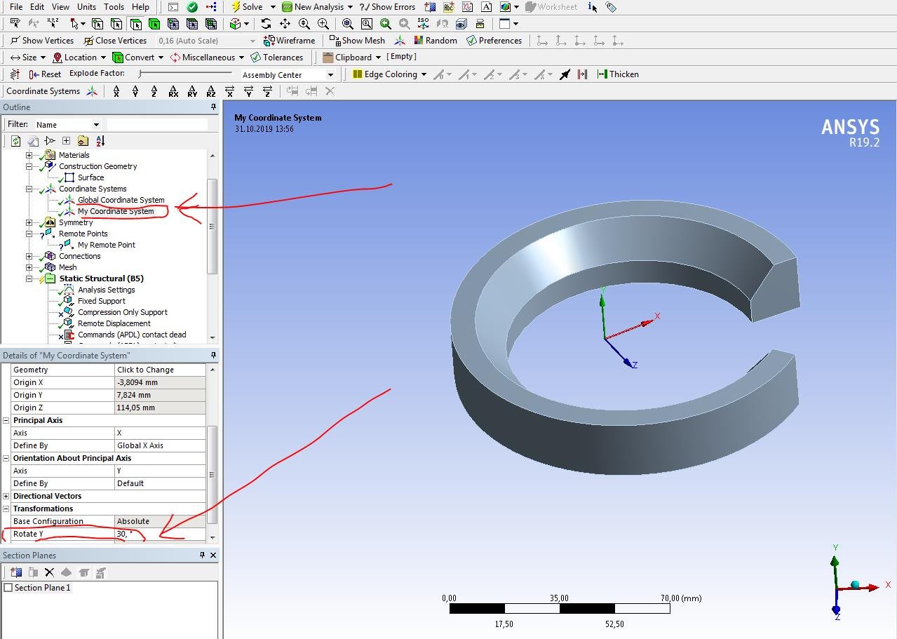

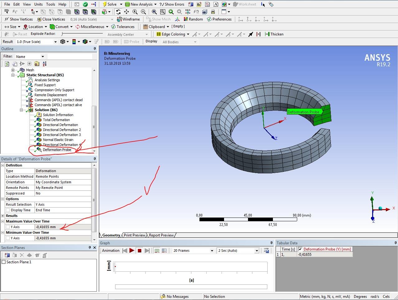

i am a Simulation Beginner and i simulate a Piston Ring with Ansys Workbench Mechanical and try to find the Deformation in y-axis as well as the Rotation based to the Center of gravity.
I tried the following:
- I used "Remote Point" to apply a "probe Deformation" on one face of the Ring and i obtain the result for this face (But just the Deformation). But i could not find the Way/Tool to select a nex cross section that is shifted by 30° to the previous.
-I added a coordinate System directive to one Face and rotate this coordinate in 30° to the previous Face and slice it. The Problem is, i can not select the Face in this Section plane by neither a "Probe Deformation" nor a "Remote Point", so i can't find the Deformation an Rotation of this Section Face.
I am aware that I have not really explained the problem clearly (I tried), but if anyone understands me, please help. I have attached Pictures relate to my two experimental Options. the two first Pictures are relate to the first Options. and the two last to the second option
Thank you

SubscriberHello Doug,
Open the Geometry in SpaceClaim or DesignModeler. Create planes at 30 degree intervals and use those planes to slice the body into pieces, then assemble those pieces into a Multi-body part (Form New Part in DesignModeler or Share Topology in SpaceClaim).
Then you will have a face at every 30 degree interval to do the Remote Point Deformation Probe.

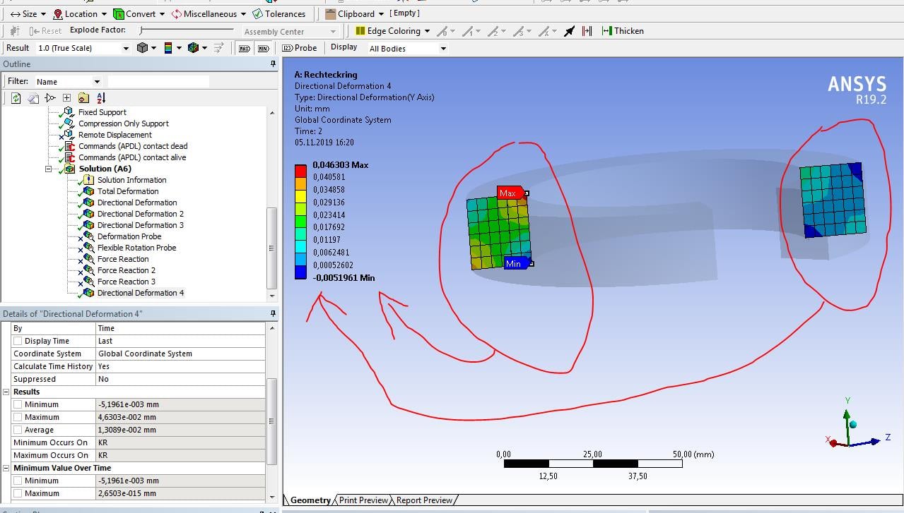

Doug
SubscriberHi Peter.
I've found that I can not slice the ring in section because "Bonded" causes intersections and changes in results.
So I tried "Constructions surface", but I could not show the results of just one cross section. (In the pictures below, only the average of the two cross sections can be displayed, but I only need one cross section)
can one way, the deformation of only one cross-section and another sunk by 30 °? Without cuting or separating the assembly?
November 6, 2019 at 11:12 am
peteroznewman
SubscriberNo, you can't get just one part of the slice, you can only get both sides.
You can export the nodal data from the slice, and easily filter out one set of nodes using coordinate values.
Then you can compute the rotation from the remaining nodes. You will have to do some research to learn the equations to solve to obtain the rotation of that set of points in space.
It might be a lot less work to learn how to do mesh connections. Those are easy by comparison.
For the Bonded contact, did you try setting the Formulation to MPC? You should be able to get the Bonded contact to give results almost identical to continuous mesh.
