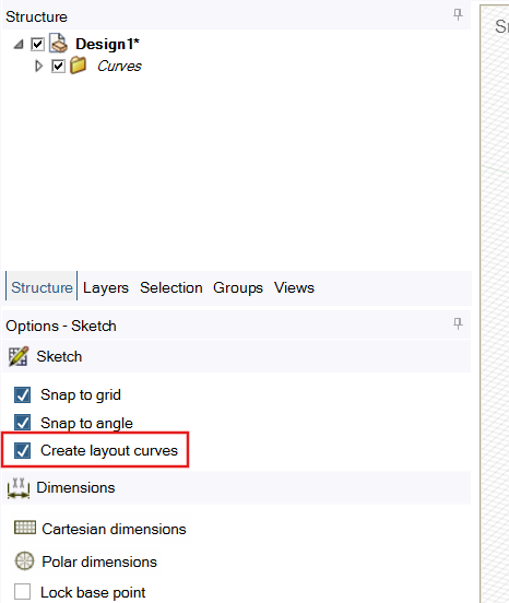

      I draw a sketch and i want to stay in sketch mode when i am creating a circular pattern but when i click the circular pattern button spaceclaim automaticly creates surfaces with my sketch. How can i stay in sketch mode when i am creating the circular pattern?
    • Yusuf Arslan
      btw i use 2025 R2 student edition
    • Devendra Badgujar
      You will need to turn this Layout curves option on when sketcking and then go with circular pattern.
      Let me know if this helps.
      Devendra

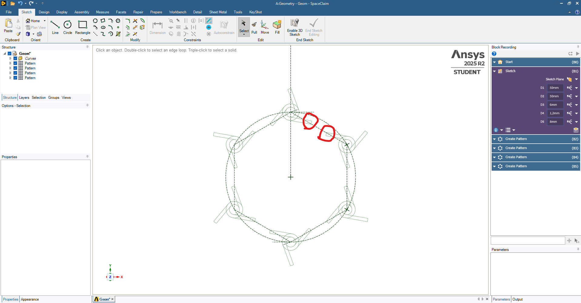

    • Yusuf Arslan
      Firstly thank you for your answer let me give you more information, i am working on auxetic structure parametricly and i cannot reach some measurements right now like R of the big circle and to escape the calculations i want to set a constraint between legs which are marked with red circle. Is there any way set constraints here i want to make them parallel and coincedent?
