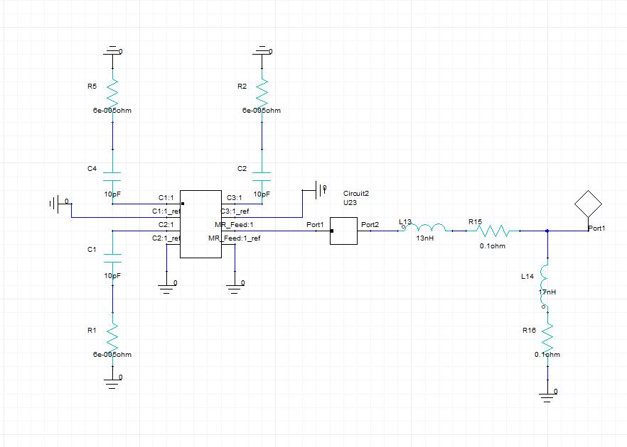

Julia
SubscriberThat was very helpful, thank you!Â
This is an example of a schematic (with only one feed port for the 127MHz and not including the 2.4GHz port). However, is this the correct way to model the series capacitors and excitations at the feed ports using the reference pins to ground? Or should the capacitors be connected across the ports?Â
December 11, 2018 at 7:14 pm
Sorceress Gia
Ansys EmployeeNo, you should connect the capacitors directly between the ports' respective terminals; e.g. C4 will connect between C1:1 and C1:1_ref and R5 can be deleted (unless you want to add in the ESR of the capacitors to your model).

Julia
SubscriberThat makes sense, thank you!

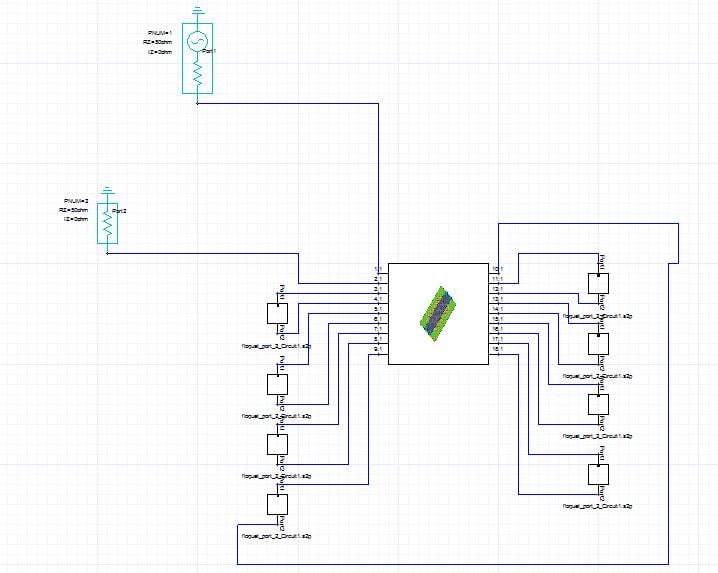

Swadesh
SubscriberHi @Peter,
My situation is something similar. If I design a 2 port isolator what should be the applied external voltage or power? Solution type is driven modal where port 1 is 1 W and port 2 is 0W in HFSS model. In this below figure, I have created various lumped ports in order to insert touchstone file. But for port 1 and port 2, do I need to define 1V or 1W for each or only one port at solution frequency. Besides, when I do push excitation, soft tells, unable to extract voltage from parent solution. What does that mean?
