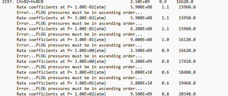

      I am working with ANSYS CHEMKIN PRO 2021-R2.
      For my analysis I was able to find mechanism file and transport file but could not find the thermo file. So I wrote the thermo file. When I run the processor it Gas.out says 'WARNING...THERE IS AN ERROR IN THE LINKING FILE, DUE TO MECHANISM INPUT ERRORS.'
      Can you guys please help me how to resolve the errors?

      This error message looks like the issue with the chemkin files and mechanism order/format you are using. You can find the chemkin files in the Ansys installation directory. Can you please check with the mechanisms files available in the installation directory. You can find it in the Ansys inc--> (version) --> reaction --> data.

      Thank you for help. I was able to remove the error. However, I am getting another error. Its says 'Error...PLOG pressures must be in ascending order...'. However, PLOG pressures are already in ascending order.  I have insterted the screenshot of the error. Could you please help me how to remove this error. I would be really thankul to you.
